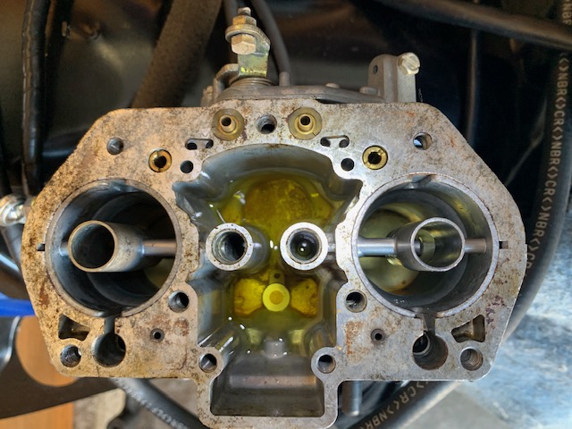

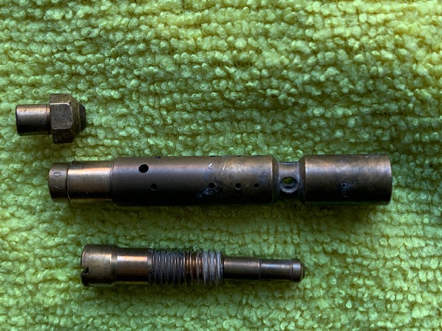

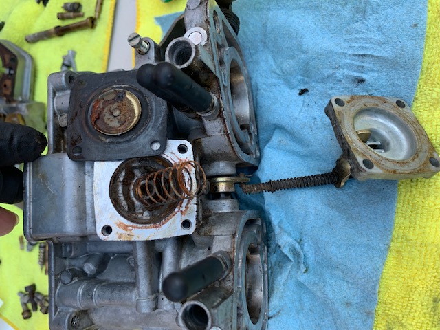

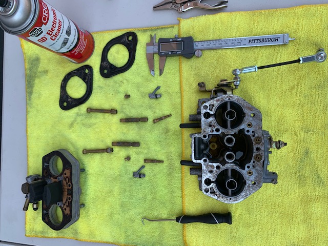

Last week I test run my engine on my garage floor and a little rough idle. So I ended up rebuilding/cleaning them and lots of dirt inside (acquired the 36 IDF used along with the engine). I think it is pretty straight forward to clean this carb but I have no much idea with jet combinations. I just assumed the jets on it will be fine since this was a running engine with the current set up.
