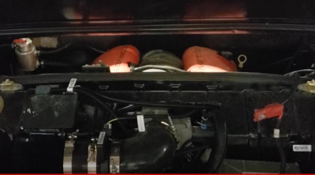

Ok, another update. Been building steel parts and welding, as I take breaks from the smoke and fire I am slowly trying to get the mechanical bits of this car ready for its first road test.
Currently finishing up some wiring but I have made progress with the drivetrain install, shifter, clutch and brake assembly.
Here is a short video of the engine starting up. I must say i was surprised it went as well as it did. No mufflers yet, exhaust to follow soon.
914 LS6 startup Attached Image
