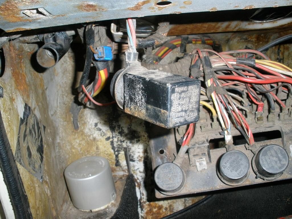

The mystery relay
Addedum-relay number 002479-01 is the turn signal/hazard flasher. Duh.

[quote name='HalfMoon' post='2054661' date='Jun 26 2014, 03:22 PM']
The mystery relay
looking for the location of this relay (the one hanging)....is it tucked up there somewhere?

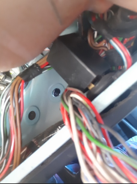

Hello at all, I'm Carmine Borraccino From Italy this is the first time for me on this wonderful forum. I saw the "Mystery relay" on my '73 1.7 914 during the substitution of the lights switch, its rubber socket is mounted on the lower frame of the dashboard, hope this can help you.
