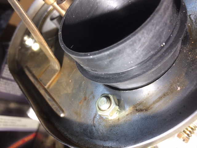

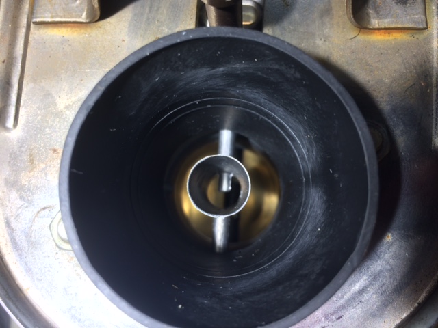

The German Snail has arrived, but I seem to have a problem. The snout seems to be too long. It is sitting on the (not sure what it is called) cross bar in side the barrel thus it does not seal up. I am thinking of cutting it around the bar, or making it shorter? Or maybe find a large O-ring to set on the plate.
Thoughts?

@malcolm2
Look at the fittings on the STE in this ad:
https://www.cbperformance.com/product-p/6537.htm
Take that adapter off and see what is underneath. That adapter works well if you have velocity stacks on your carbs. You don't. Hence the problem. Not insurmountable, but... you may be able to home brew it depending on what's under the adapter you have or even with that adapter.
I have had a German STE for 20 years. Never needed anything else.
I have used Perry's ( @IronHillRestorations ) carb tuning guide many, many times over the years. I read it to refresh my memory every time I have to go in and do it again.
I think the biggest concern here is you don't want to spend too much time dickin around tuning and syncing carbs before you get that cam break in done. And I don't know how perfect it needs to be just to do a cam break in. I'll leave that to the experts. I'm just dangerous and headin for a meltdown. (IMG:style_emoticons/default/happy11.gif)
Linkage bushing - Check your local hardware store's supplies of plastic bushings. You'll probably find something that works. It doesn't need to be perfect or exactly like the other at this point.
