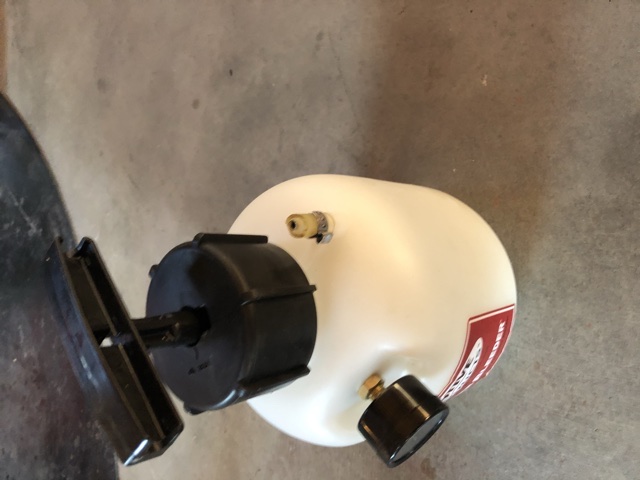

I see a couple threads on brake related items so this is fitting. I have been busy the last few weeks (more to come on progress) but need to fast forward to last night.
Bleeding my brakes with my Motive pressure bleeder as I have done numerous times before. I am at the right rear wheel and hear what sounds like a sprinkler...in my garage.
Stand up and go to front of car and there is a heavy stream of brake fluid, more like a gusher, shooting up at underside of the hood and coming down all over the front of the car (IMG:style_emoticons/default/blink.gif)
We all know brake fluid and paint don’t match right? Long story short I cleaned up what I could, rinsed with a bunch of water, followed by dish soap and then another rinse. I didn’t see any paint residue while cleaning so may have gotten lucky.
Oh yeah the culprit was the hose that connects to the bleeder tank ruptured. I know things can fail but not sure if I will be using it again any time soon.
