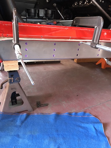

So going back a few weeks I finished up my 914LTD install. The driver side went on pretty smooth with my lessons learned from the passenger side. Also I wasn't fighting a bent long and a bunch of preload (best I can assume) so it was really just getting it set in place.
Here are some pics fro the passenger side and notes about the install.
I added a few extra holes for each rib, and in hindsight, the lower ones shown were too low and didn't make good contact with the long. After tacking the two pieces together I removed it through the rear wheel well to finish welding them together on the ground; with the Sheridan kit I couldn't do it on the car.
