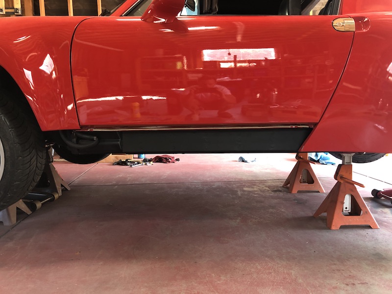

FL000
post Oct 11 2020, 11:51 AM
Posts: 489
Joined: 31-January 12
From: Lancaster, CA
Member No.: 14,076
Some finish work on the welds, liberal use of seam sealer, and paint to call it good.

FL 000   So going back a few weeks I finished up my 914LTD ...   Oct 11 2020, 11:42 AM
FL 000   Some finish work on the welds, liberal use of seam...   Oct 11 2020, 11:51 AM
