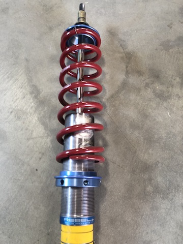

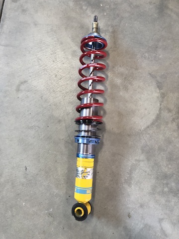

Years ago when I installed my coil overs I cheaped out on the helper springs and used some wire to keep the spring attached to the top hat. Every time you lift the car the lower part of the springs rise out of their seat and need to find their way back in when lowered. As you can see from the picture it can give your threaded sleeve a beating. I know others have done this successfully so to each their own. I added the helpers since I was already in there.
