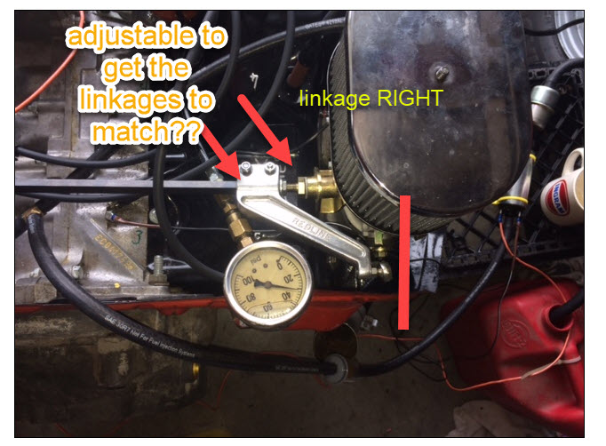

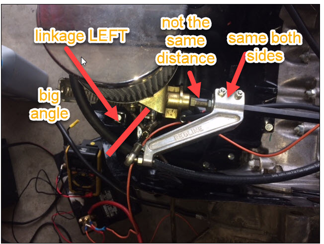

I love when a plan comes together..... Well almost.
Pulled and soaked and cleaned the carbs. Set the screws, removed the linkage, got new NON-metalic plug wires. BOOM. ran nice even before the carb balancing. Balanced the carbs with the linkage off... attempted to get the linkage right, but did not. Got close enough for the garage floor.
Once that was done, I checked the timing. Also pretty good. Let her run for 20 minutes at about 2000 rpm. Love the throaty carb sound....
I assume I am gonna need to adjust all the nuts, etc.... on the linkage. I got the turn buckles the same length and that was a big mess. Then just got it "good enough" for break in. Man it sounds really good.
Attached ImageAttached Image

malcolm2   I am back at it after a Fall Break with the wife. ...   Oct 10 2020, 11:56 AM
Gint   I am back at it after a Fall Break with the wife....   Oct 11 2020, 08:49 AM
malcolm2   Linkage bushing - Check your local hardware sto...   Oct 11 2020, 12:24 PM

malcolm2   Linkage is still wacky, but I got it DONE. 1.8 li...   Oct 11 2020, 12:19 PM
jtprettyman   Linkage is still wacky, but I got it DONE. 1.8 l...   Oct 11 2020, 01:22 PM
Gint   Not necessarily. The entire thing operates as a u...   Oct 11 2020, 12:31 PM
Superhawk996   Great Job! :Qarl: Love the cacophony of a...   Oct 11 2020, 01:06 PM
IronHillRestorations   I've seen it with springs on both sides, and s...   Oct 11 2020, 09:32 PM
