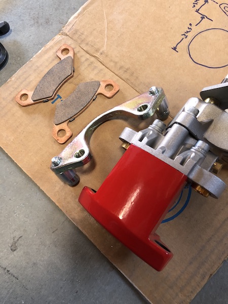

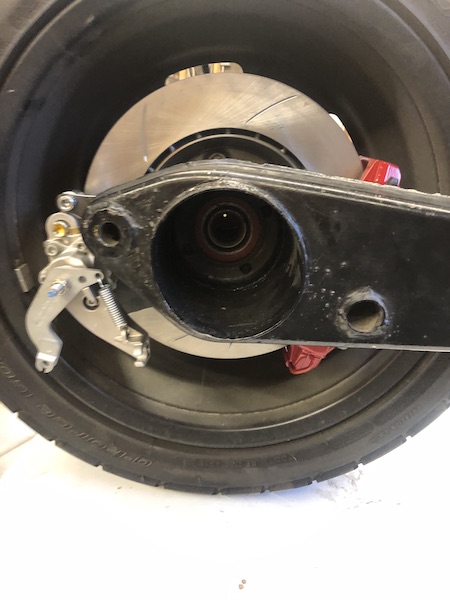

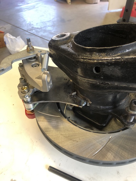

Next I moved onto the fun stuff I have been looking forward to for a while. I acquired a set of Boxster S calipers, rotors, and adapters recently (hat tip to Stephen @914forme ) and figured with the trailing arms off I was already halfway there.
If you are this far into my thread you clearly know I don't mind deviating from the beaten path and open to trying a different approach. I really want to have a parking brake when this is done, but wasn't having great luck finding the 911 parts. I decided to go with the Wilwood MC-4 style parking brake. I knew it would require some fabrication and a different cable to make it work.
These pics were during the mockup but you can see where I am trying to go with it.
