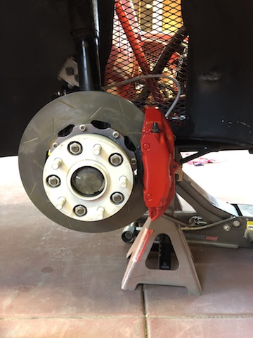

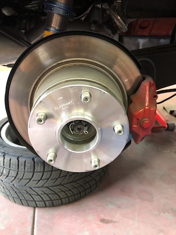

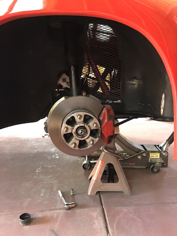

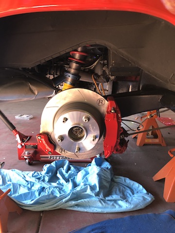

FL 000   I see a couple threads on brake related items so t...   Oct 11 2020, 09:05 AM
76-914   :blink: :wacko:   Oct 11 2020, 09:20 AM
FL 000   So going back a few weeks I finished up my 914LTD ...   Oct 11 2020, 11:42 AM
FL 000   Some finish work on the welds, liberal use of seam...   Oct 11 2020, 11:51 AM
FL 000   I noticed my rear trailing arm bushings were not i...   Oct 11 2020, 12:01 PM
FL 000   Next I moved onto the fun stuff I have been lookin...   Oct 11 2020, 12:13 PM
FL 000   Got to love these comparison pics. I know there ar...   Oct 11 2020, 12:28 PM
