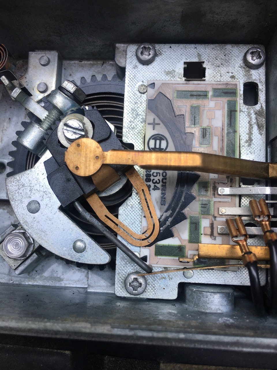

I just want to give a shout out to Dave Sprinkle who is now making brand new TPS circuit boards for the 914 FI system.
This is seriously the best $35 I've spent on the 914 in as long as I can remember. It's a simple installation with the included instructions, and only took me about 30 minutes. After this, all of the jerkiness in the acceleration was gone just like that.
A new TPS is NLA, and cost about $150+ last I checked when they were available. This $30 part restores the switch, so get one while you can.

Hey @Davesprinkle , we meet again! (Talhina ride and some Dallas events) anywho...
Ive read through this thread and also done a fair amount of researching any mention of a 1.8 DJet TPS board???
Did you happen to make these by chance and if so what is the best means to contact and procure?
Thanks for your amazing dedication!
John Foster
1974 Ravenna Green 1.8 (Wazabi)Attached Image

John, thanks for the kind words. Sorry, I never made any of the Ljet boards. Not sure how you would go about getting that fixed. Probably just need to get a replacement sensor.
With regard to the Djet boards, I have a handful left, but I'm not going to make any more. I believe that 914rubber is now making these. I'm glad to have supported the community with these, but there's just not a big enough market to support two vendors.
