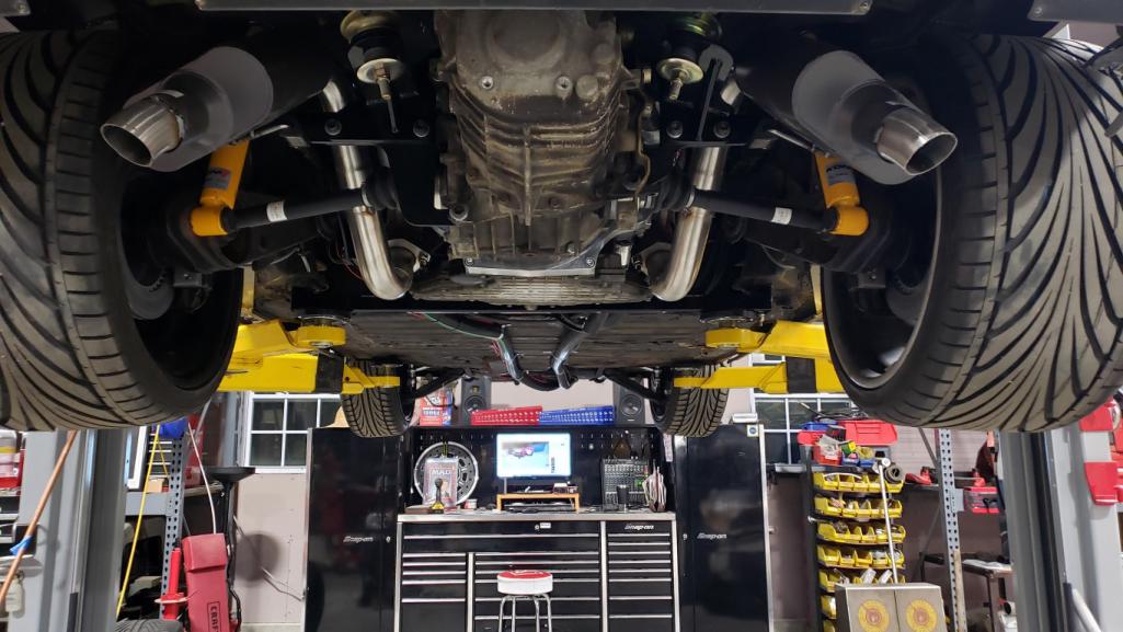

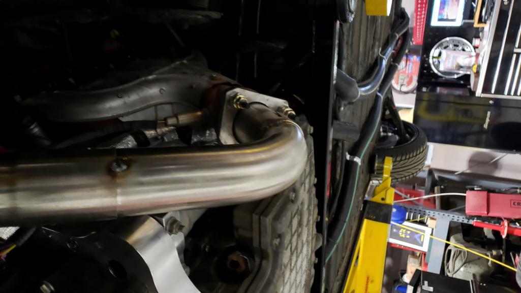

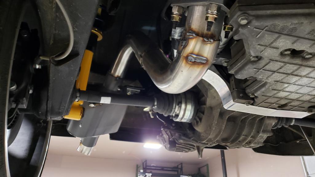

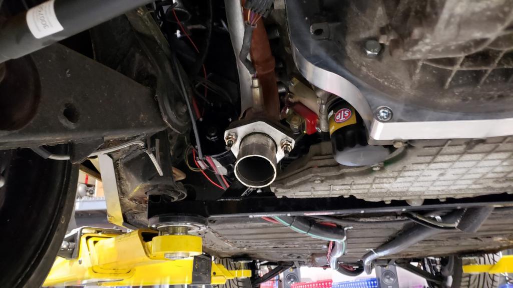

Got the seats and the exhaust ready for testing. Now I just need to get some help on the wiring for the headlights (IMG:style_emoticons/default/smile.gif)
planning the attack
Testing some bends
Plenty of clearance
Looking good for a 30min test exhaust...
Parts were acquired via amazon for under 200.... Enough material left over to still build about 4 more exhausts.
