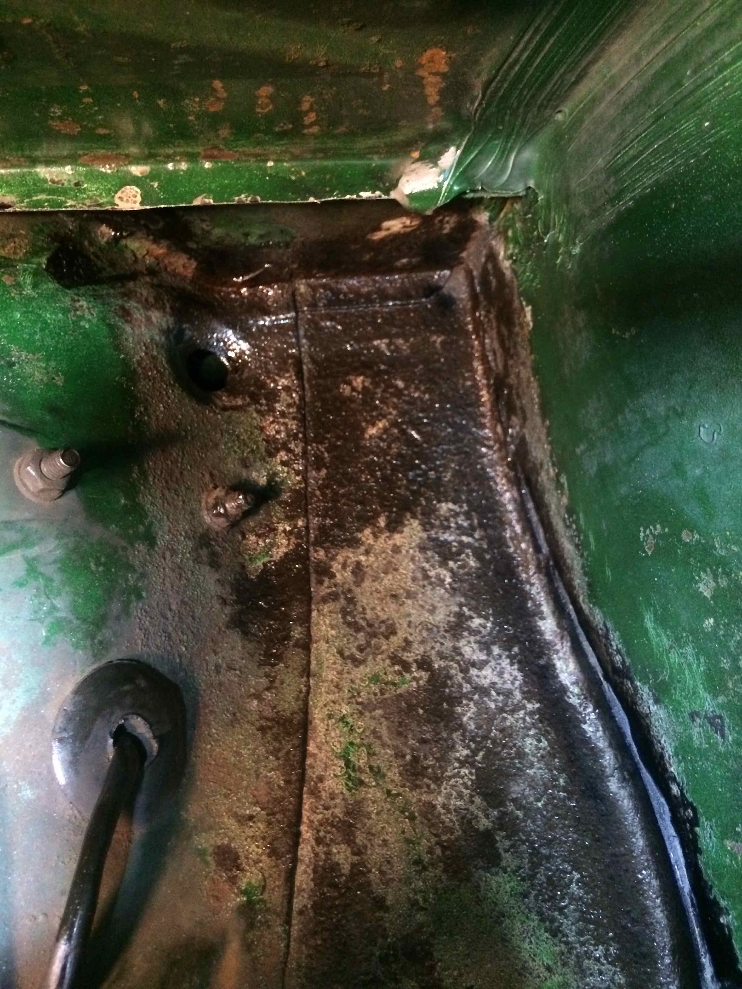

given the caliber of 914 stewardship here, i kind of already know...
i'm in the midst of installing a "new to me" 1.7. not intended to be the "end all, be all" powertrain, this is more of a "tide me over" until i do my long intended small block conversion. as expected, i'm doing a lot of "while i'm in there..." work.
after taking a wire wheel to my battery tray and hell hole, there's more of "less" in the former, while the later is still solid. battery tray support is also still solid. tray itself feels solid, i've been using it as a step to get in and out of the engine bay to do things like body to motor mount bar brackest, upgrade firewall shifter bushing, fuel lines (while i'm in there stuff) etc...
is replacing the battery tray an "i can't believe you haven't done this already?!", or can i put it off a few more years (until the engine upgrade) with rust treatment? the car will almost never see rain, will be driven very occasionally and lives in a garage. anybody have a battery go "walkabout" while driving due to such a tray?

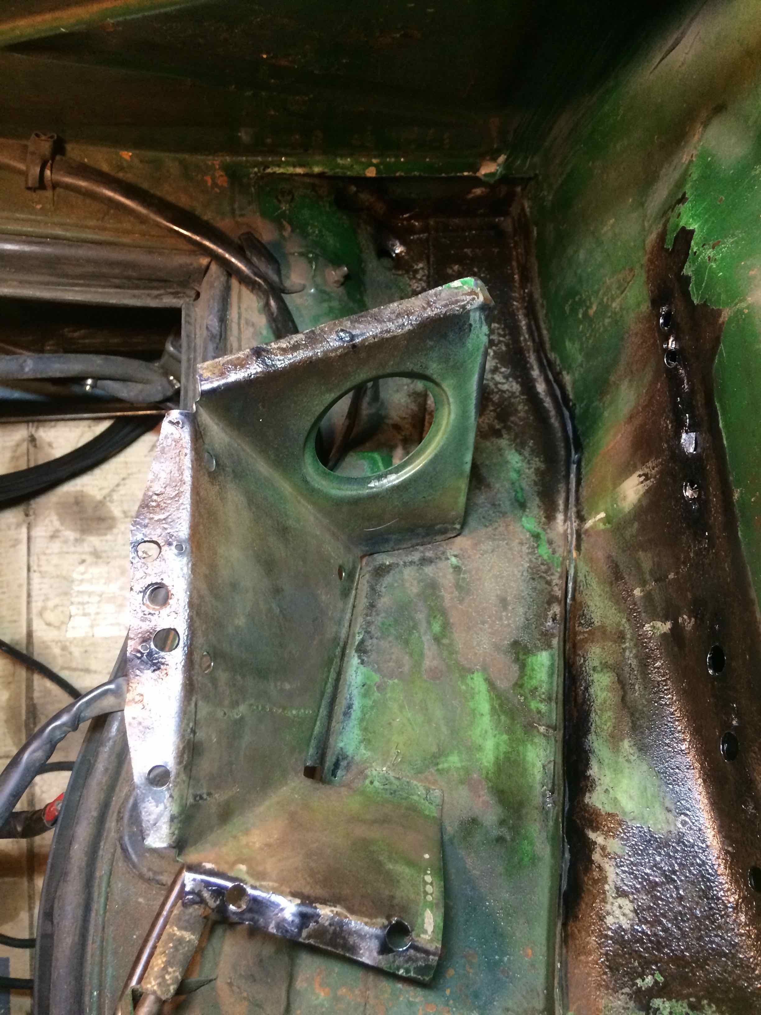

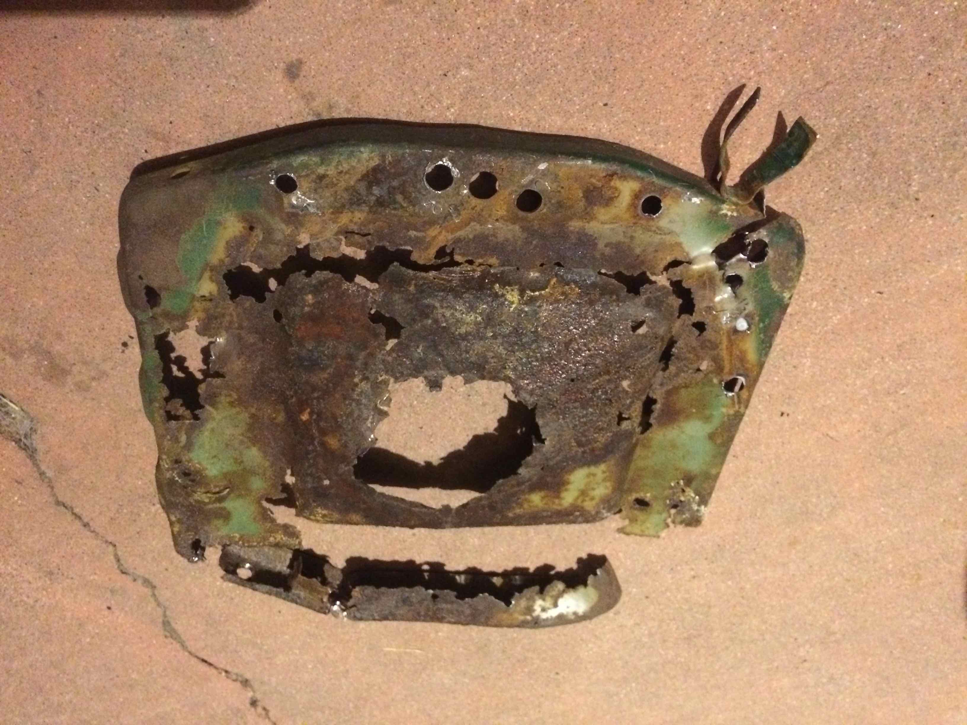

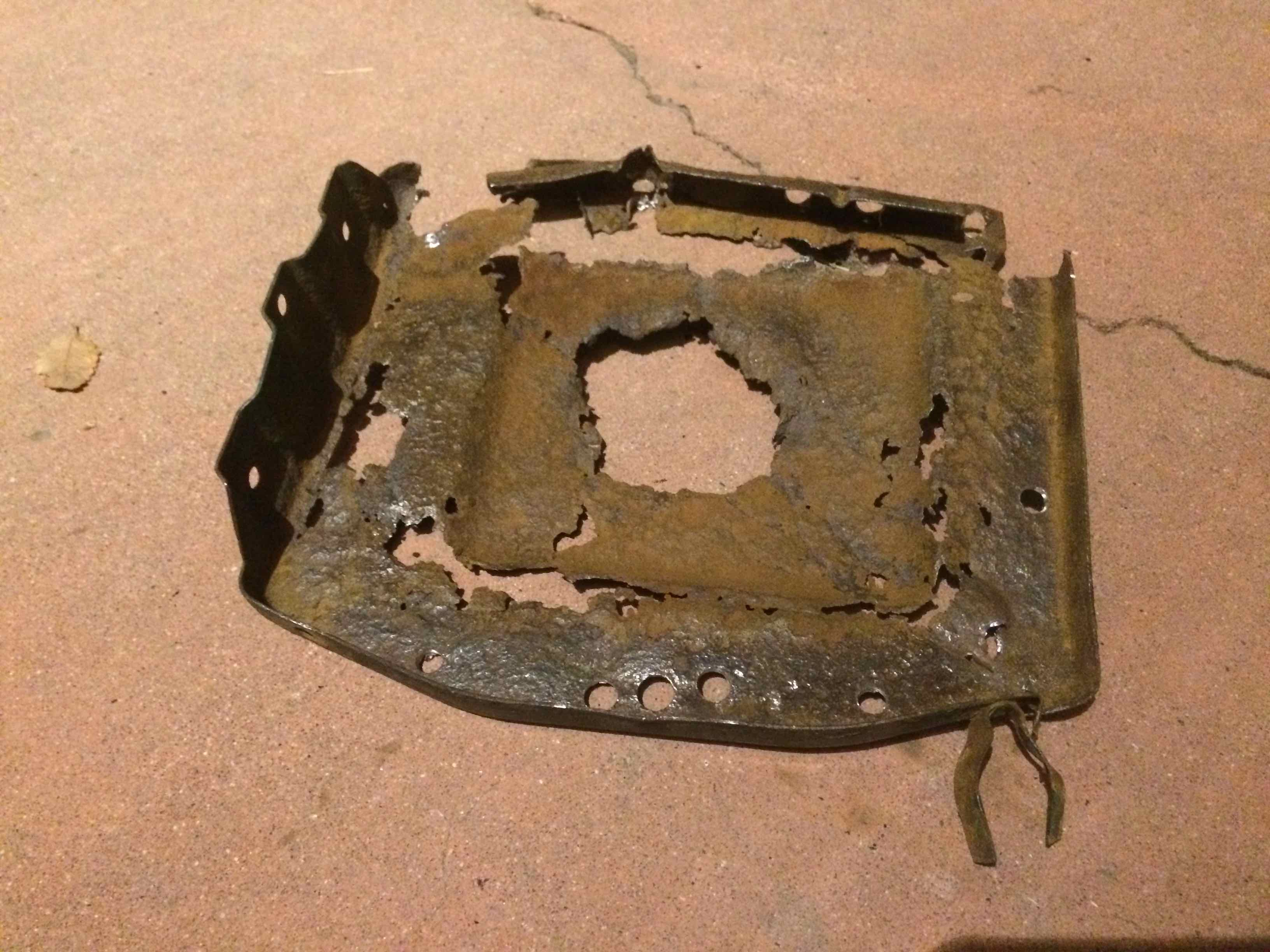

finally some progress on this, intervening was the power steering rack on my '83 accord (53k miles!) which sprung a rather large leak, forcing me to learn steering rack replacement but, i digress... let's just say the drive to the alignment shop a few miles away on city streets was "interesting"...
probably shoulda called in experienced help on this but, the rusty battery tray's out. i was contemplating even sharing this (not my best work) but, figure it might be a lesson to someone else. i had a helluva time figuring out (i mean missing) where the spot welds were. easy enough to see the little dimples on clean sheet metal but, i was kinda drillin' blind here. after going at it with a wire brush on my cordless drill, i used a permetex product that sprays on in 2-3 light coats as clear, turning black where it finds rust (pics taken several hours later).
as you can see, i decided on a hybrid bolt in, given the condition of the support and my bumbling attempts on removal of just the tray...

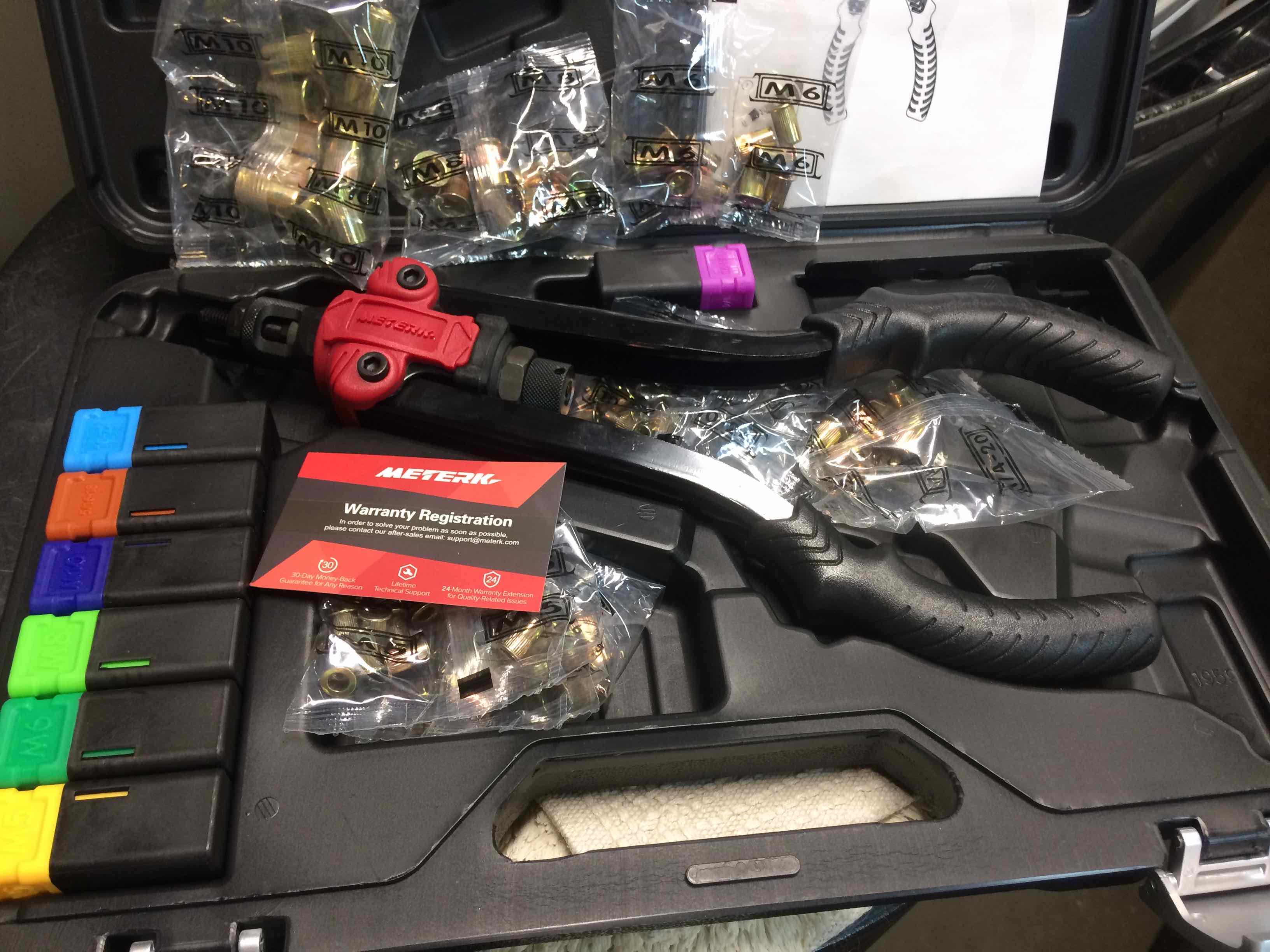

i guess i'll use the holes i've already made to mark the new tray and carefully drill. debating if i want to use the threaded inserts that came with my new toy or just regular bolts as there's decent access.

pt_700   nutsert is one of the products (rivetnuts too). l...   Oct 6 2020, 12:11 PM
