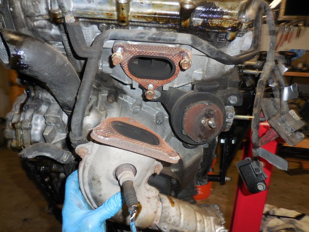

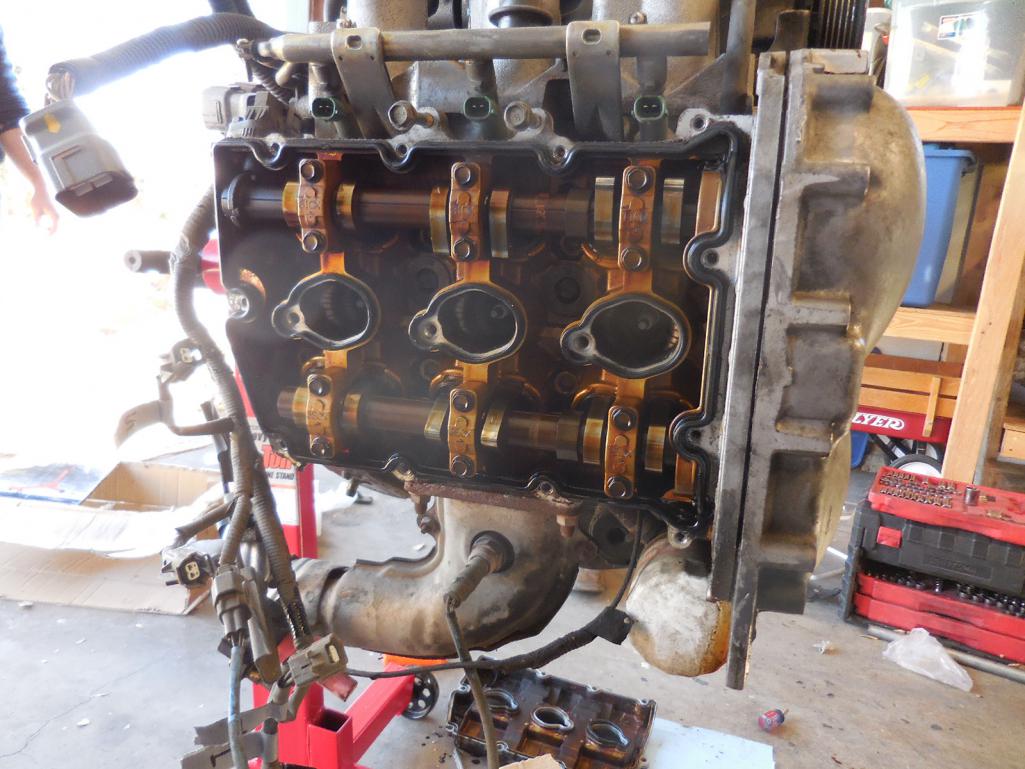

So i started in on replacing the gaskets on the ez30 subaru engine and holy shit im learning a ton. Got her up on an engine stand and i watched a youtube video of a guy that did this project without taking it out of a subaru. gives me a new respect for those that attempt it.

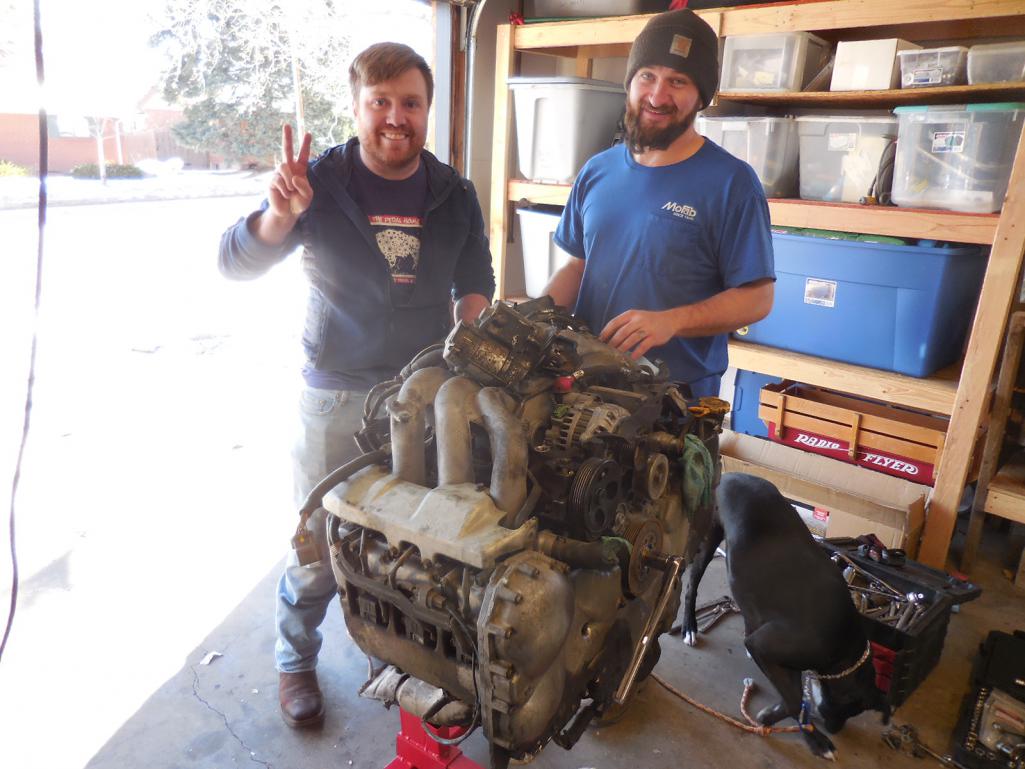

Step 1 of 2,600: Got her up on the engine stand
(yes we all felt accomplished so we sat around patting each others backs for the next 40 minutes)
got one side off

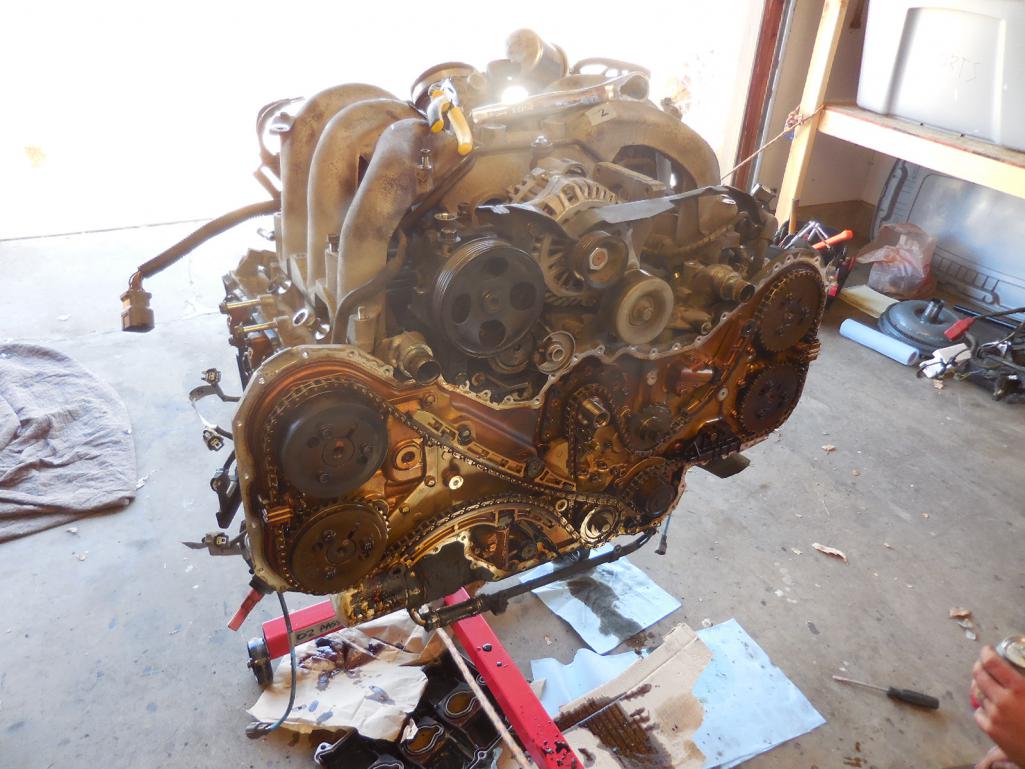

removed cover to expose timing chain
removed exhaust on each end
