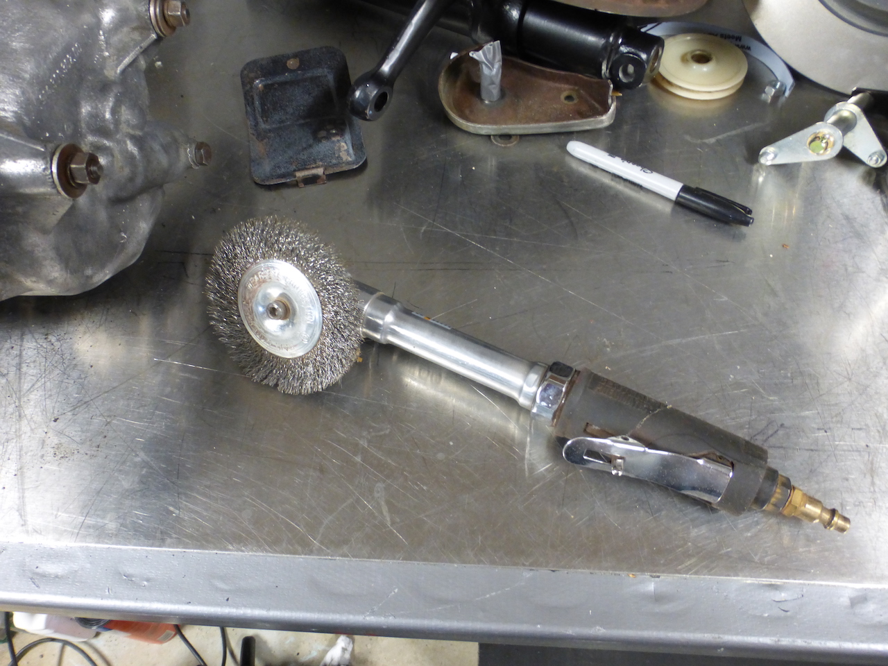

PT 700, using revnuts...make sure they fit very tight to the hole you drill. And second, to clean up hell hole buy a cheap HF extended grinder, then cut off the 1/4 shaft on the wire wheel and drill out to fit. Work great for cleaning up tight areas like that and in inner fender. I used it on the entire bottom of my car. Best, MarkAttached Image
