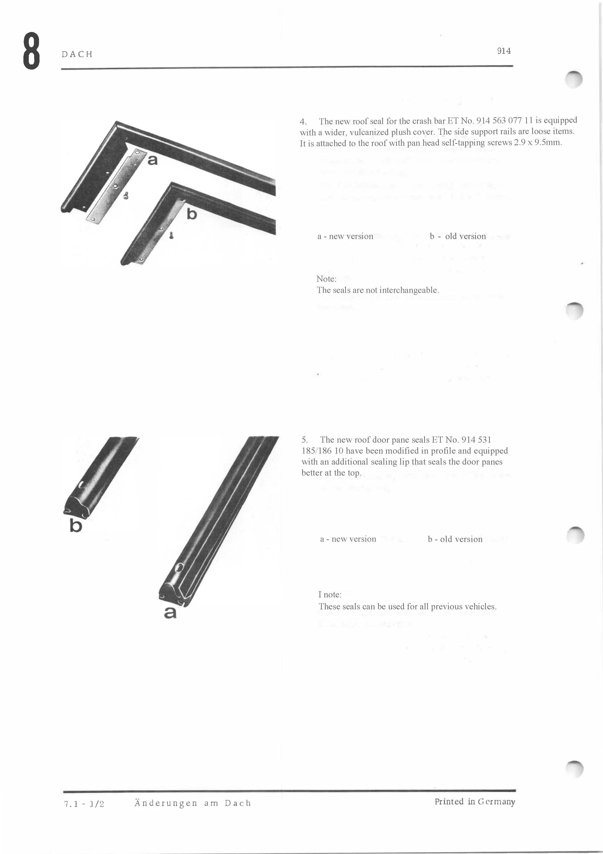

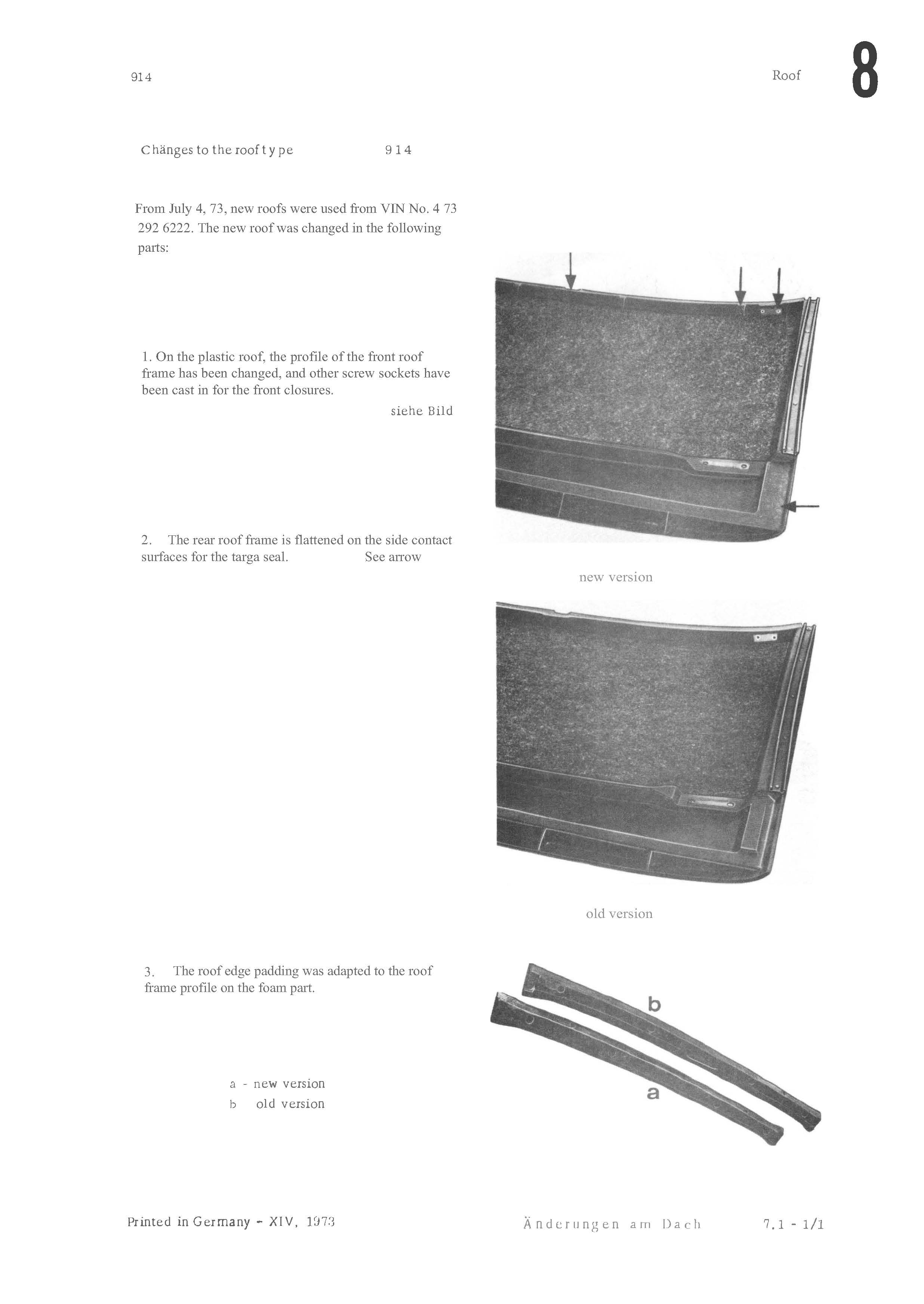

Good evening,
I am quite new to the forum but have already enjoyed a lot of different topics and find them quite helpful and motivating.
Hope to contribute to this one. Looking at my Porsche 914 workshop manual I found the following information about the change of the roof:
From July 4, 73, new roofs were used from VIN No. 4 73 292 6222.
Further on Porsche introduced a new seal for the rear part that is not interchangeabel.
I have tried to translate both sides that are covering the roof changes and attached them.
Holger
