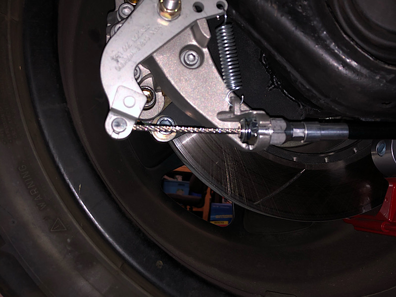

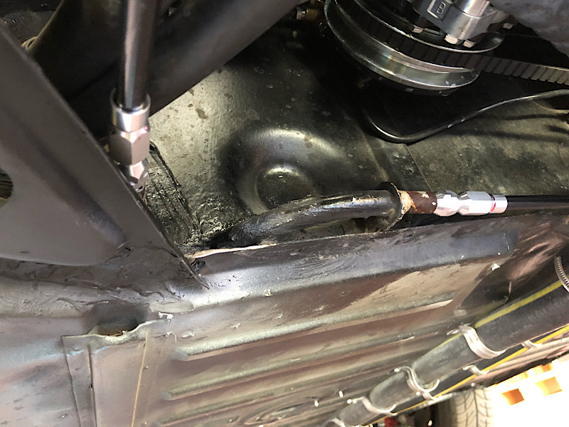

Wow, loving the big brakes. Haven’t done a full on panic stop yet but all indications say way more braking capacity available than my previous setup. I did the PMB recommended bedding-in procedure and putting some miles on it to build confidence.
Also changed my little plastic do-dad in the passenger door exterior handle and that door opens fairly easily now. May still address the door gap down the road but satisfied with functionality for now.
Went full circle on the parking brake cables and turns out Wilwood makes a universal kit for their caliper - go figure (IMG:style_emoticons/default/chair.gif)
I now have functional parking brakes again and here is the setup under the car:
