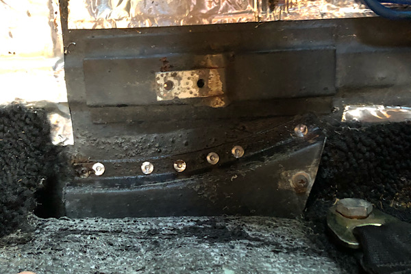

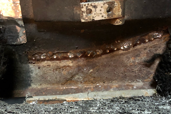

Inside the cabin I started by removing the metal guide plate. Still a mystery to me in identifying where all the spot welds are (IMG:style_emoticons/default/smile.gif)
I didn’t want to prep and spray paint in this area, so I put down some Ospho to at least coat it and hopefully ward off any future rust.

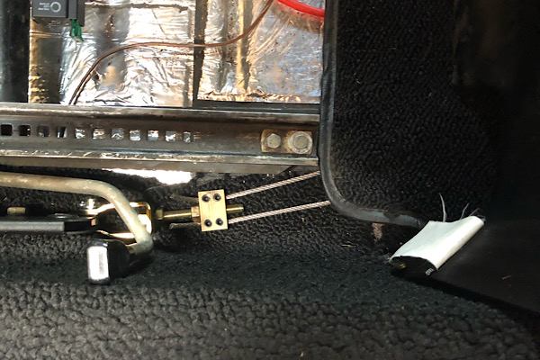

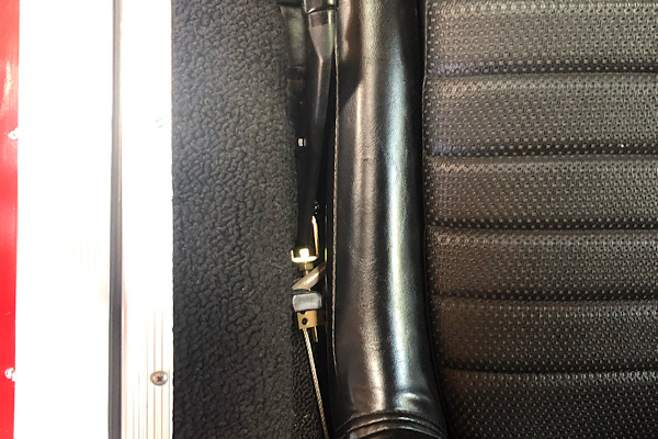

Ran the steel cables through the factory pipes and this is the (almost) final setup. You’ll note the angle of the wires to the handle is a bit extreme. I think I will go back in and use part of the guide plate I removed to help correct the angle and put less stress on the handle. Another day (IMG:style_emoticons/default/beer3.gif)
