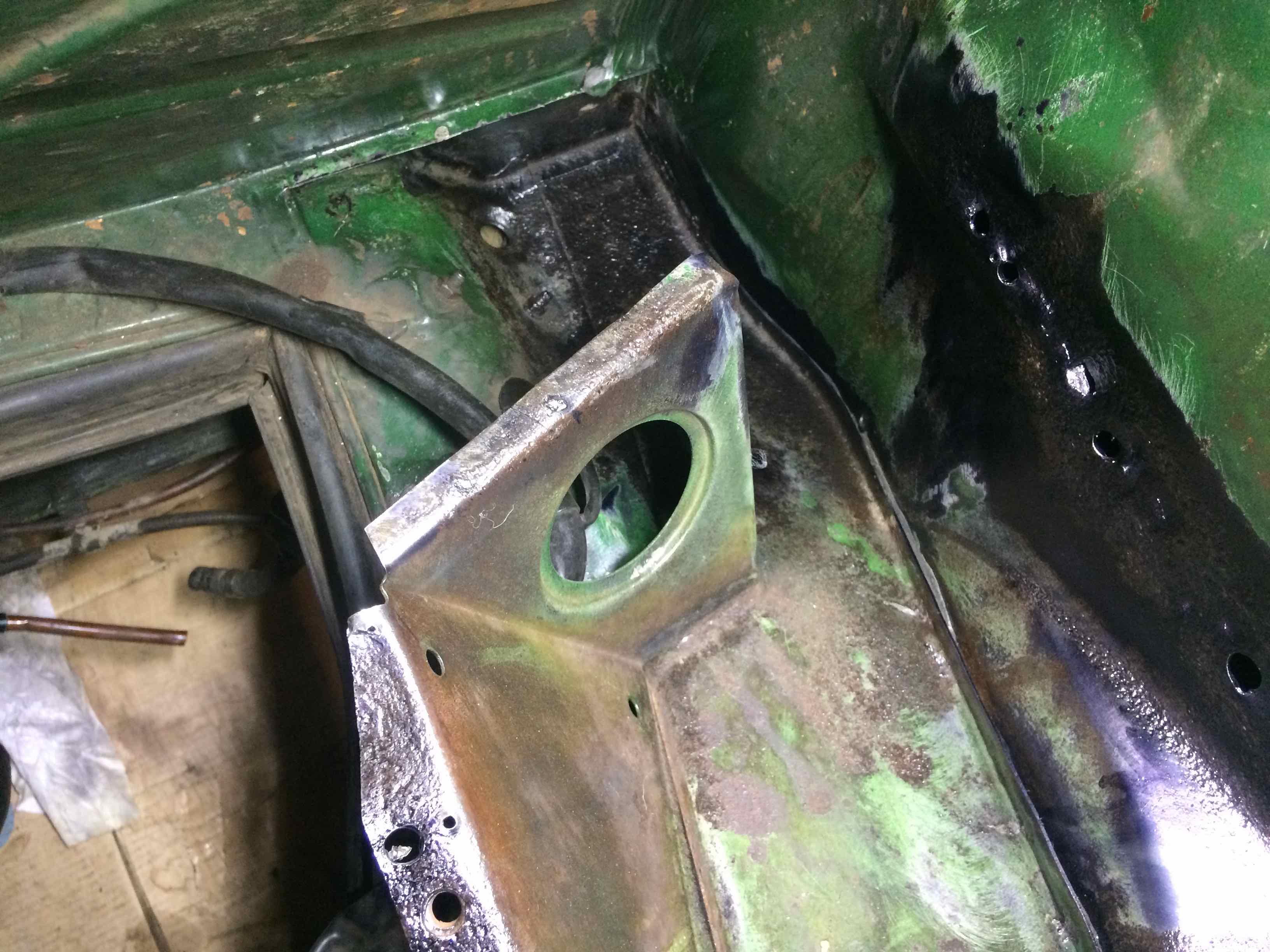

i'm in the midst of installing a "new to me" 1.7. not intended to be the "end all, be all" powertrain, this is more of a "tide me over" until i do my long intended small block conversion. as expected, i'm doing a lot of "while i'm in there..." work.
after taking a wire wheel to my battery tray and hell hole, there's more of "less" in the former, while the later is still solid. battery tray support is also still solid. tray itself feels solid, i've been using it as a step to get in and out of the engine bay to do things like body to motor mount bar brackest, upgrade firewall shifter bushing, fuel lines (while i'm in there stuff) etc...
is replacing the battery tray an "i can't believe you haven't done this already?!", or can i put it off a few more years (until the engine upgrade) with rust treatment? the car will almost never see rain, will be driven very occasionally and lives in a garage. anybody have a battery go "walkabout" while driving due to such a tray?

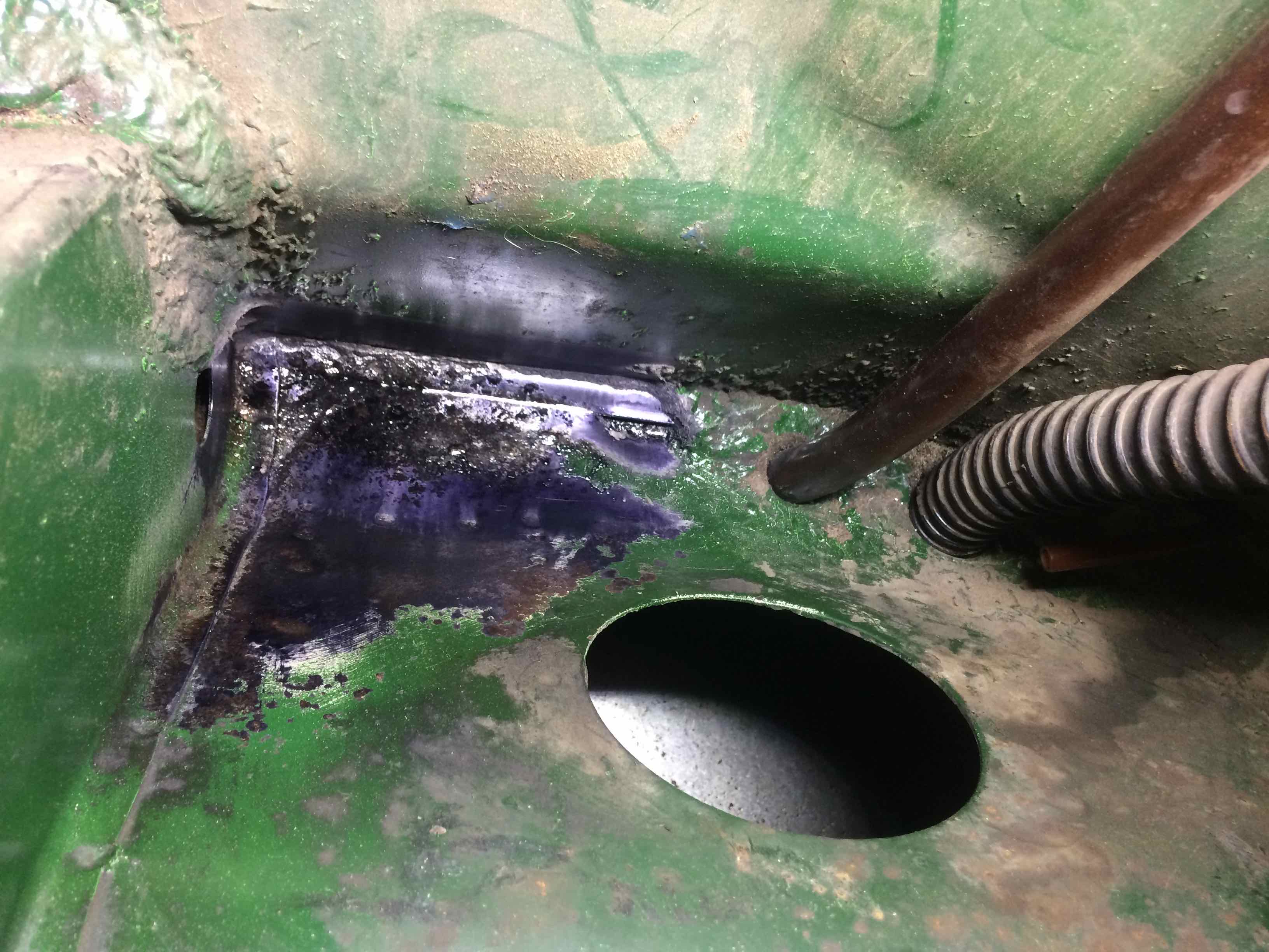

one small step forward, two steps back... not unexpected on a 50 year old, semi-neglected car...
round 2 of wire wheel / rust treatment on the hell hole yielded much reddish dust and a similar amount of black where i'd sprayed the rust treatment. i'm hoping a new to me toy (flexible attachment for my drill to wire wheel) will allow me to get into there better. i like that right angle air grinder @mlindner has, might this be the project that drives me to pneumatic?

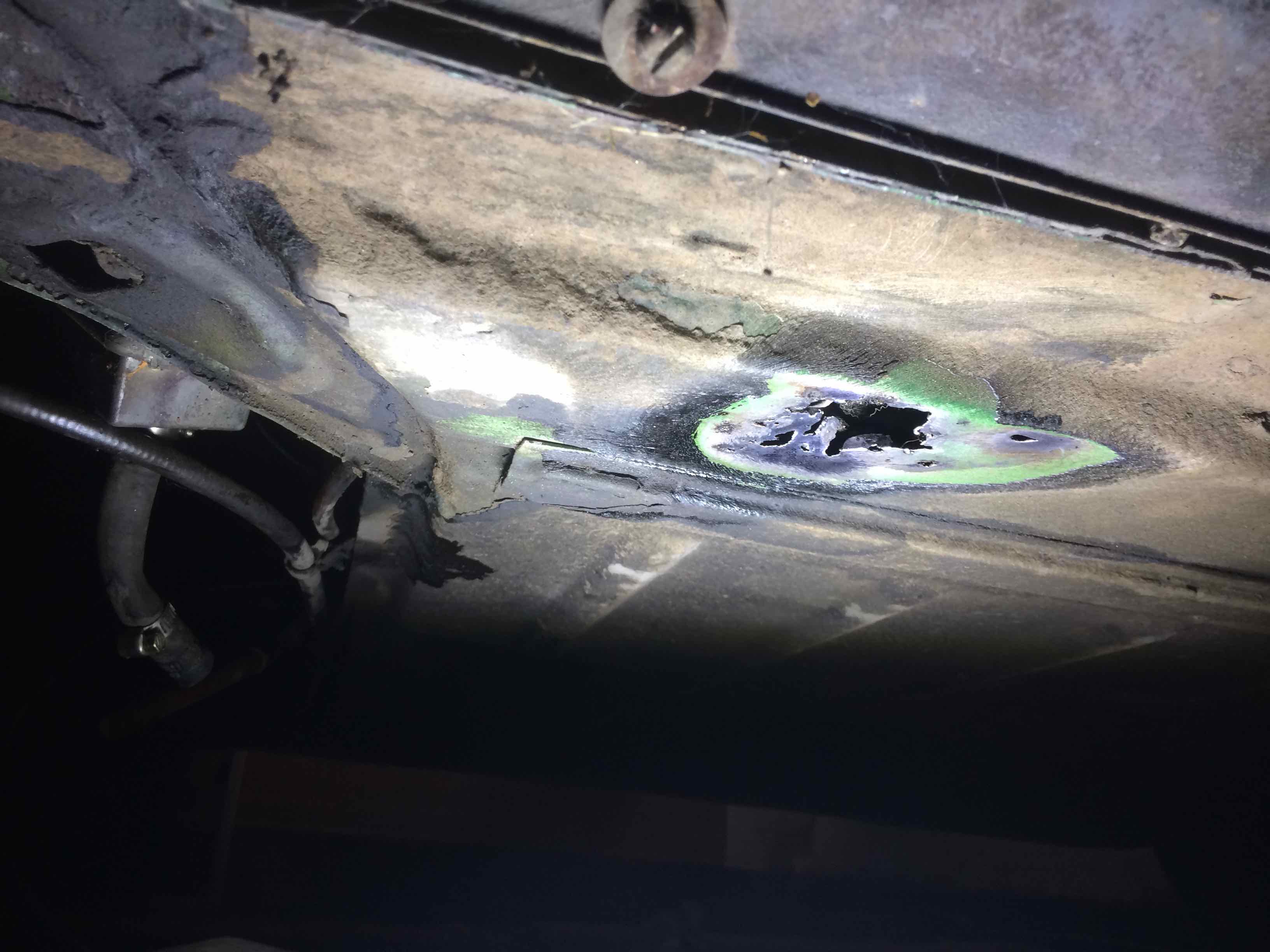

while i wait for that new toy, i decided to install tangerine racing fuel lines. "while i was in there", i found 2 new rust spots. @superhawk996 called it, i have a perforation in my floor, under the passenger seat. i've elected to clean up the bottom, spray some rust treatment through the hole and put it on my growing "to do" list... the other spot was under the fuel tank. anyone else notice the gap seen in the last picture to the left of the fuel overflow tube? the splash tray under the steering rack was a bit bent, perhaps from an encounter with a wrecker many years ago..
having seen much worse repaired here, i know i'm fortunate. like hearing "yes, it's cancer but, having caught it early, it's very treatable...".

914Sixer   Really nice, simple battery tray replacement. :b...   Sep 26 2020, 05:56 PM
BillC   I would replace the battery tray, especially while...   Sep 26 2020, 07:22 PM
Coondog   Consider yourself lucky....... :first:   Sep 26 2020, 07:27 PM
bkrantz   One other option: surgically remove the old tray, ...   Sep 26 2020, 08:32 PM
cary   Be careful removing / detaching tray from the wall...   Sep 26 2020, 10:28 PM
Superhawk996   Not sure if it is just shadowing but I think I see...   Sep 27 2020, 08:42 AM
pt_700   thankfully superhawk, those are just shadows, it...   Sep 27 2020, 11:25 AM

Tdskip   Are you sure those are shadows? Think @superhawk9...   Sep 27 2020, 11:28 AM
rjames   Like others have said, just remove the battery tra...   Sep 27 2020, 11:39 AM
VaccaRabite   Just get the part from Restoration Design. The pa...   Sep 27 2020, 06:35 PM
pt_700   tray's been ordered from restoration designs. ...   Sep 27 2020, 10:37 PM

Frankvw   in case you are going for the 'top-tray-only...   Sep 30 2020, 12:51 AM

Superhawk996   I'd love for that hell hole to have been my st...   Sep 30 2020, 08:34 AM

sholman5   Instead of welding the tray and support in place...   Sep 30 2020, 10:30 AM
pt_700   i'm liking the idea of a bolt in tray and or s...   Sep 30 2020, 11:39 AM
Frankvw   wow, great result to show for !!!...   Sep 30 2020, 11:45 AM
sholman5   i'm liking the idea of a bolt in tray and or ...   Sep 30 2020, 02:52 PM
Frankvw   Yes that helps !! "For the tray I use...   Oct 1 2020, 04:12 AM
pt_700   so, you can't get behind where you bolted the ...   Oct 1 2020, 10:08 PM
mtndawg   I’ve done a bolt down battery tray in 2 cars. Lo...   Oct 1 2020, 10:36 PM
pt_700   nutsert is one of the products (rivetnuts too). l...   Oct 6 2020, 12:11 PM

Superhawk996   having seen much worse repaired here, i know i...   Oct 19 2020, 06:27 AM
sholman5   Last picture. It is a drain for any moisture that ...   Oct 19 2020, 03:09 AM
pt_700   thanks gents! at the time i discovered that i...   Oct 19 2020, 08:18 AM
