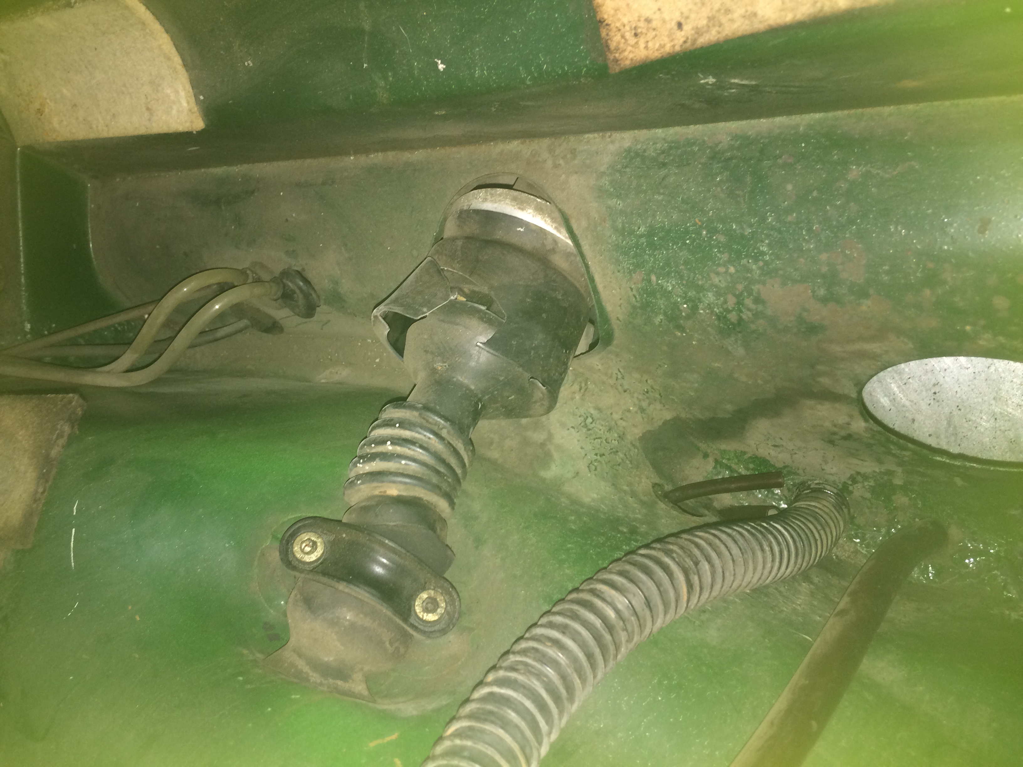

thanks gents! at the time i discovered that i thought the rubber boot over the steering was just old brittle and out of place. this morning at 3am, my mind morphed it into unibody damage from that tow... still a bit suspicious of the alignment of the shaft as it enters the rack. the rack is up against the top of the hole, rather than centered. when that wrecker went underneath the front end to grab the wheels, it pushed the spare tire well in slightly. at the time, easy fix - i just stepped inside.

Superhawk996   having seen much worse repaired here, i know i...   Oct 19 2020, 06:27 AM
