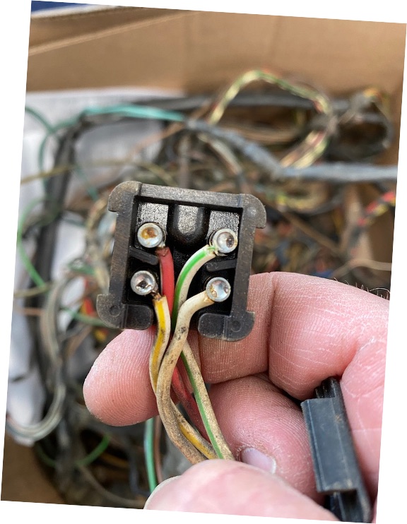

It's a nice wire harness for sure but there maybe a wiring issue that Kroon was not aware of. I need to check it out to confirm. RD is now making a replacement 914-6 harness as well. I believe the price is about the same.
Hi Luke, can you explain about the "possible wiring issue" in the fan connector ? We just checked the pictures and 5 other original 914-6 harnesses but they're all the same and identical to the new one we produce ?, Red , top left, white-green top right, white-yellow, under left, white, under right ?. Many 914-6's around the world are equipped with a new wiring loom delivered by us and this is the first time we hear about this ?
