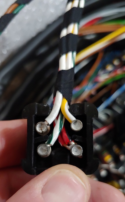

It's a nice wire harness for sure but there maybe a wiring issue that Kroon was not aware of. I need to check it out to confirm. RD is now making a replacement 914-6 harness as well. I believe the price is about the same.
Hi Luke, can you explain about the "possible wiring issue" in the fan connector ? We just checked the pictures and 5 other original 914-6 harnesses but they're all the same and identical to the new one we produce ?, Red , top left, white-green top right, white-yellow, under left, white, under right ?. Many 914-6's around the world are equipped with a new wiring loom delivered by us and this is the first time we hear about this ?
Hi Gerard,
My harness that you made seams to be ok. There was an issue with the harness that Glenn put in for a customer. Guess there were some wires not located in the proper pins for the ignition. Another member was asking for the fan housing wiring and after looking into it my kroon harness seams correct. My factory 6 harness was tampered with prior to me owning it. That's where the confusion set in but got all worked out.
Hi Gerard,

Thank you for your reply Luke, i'm just curious if this price also includes a new engine harness, wiper harness, dash harness, new relay sockets , etc ? (our set does)
