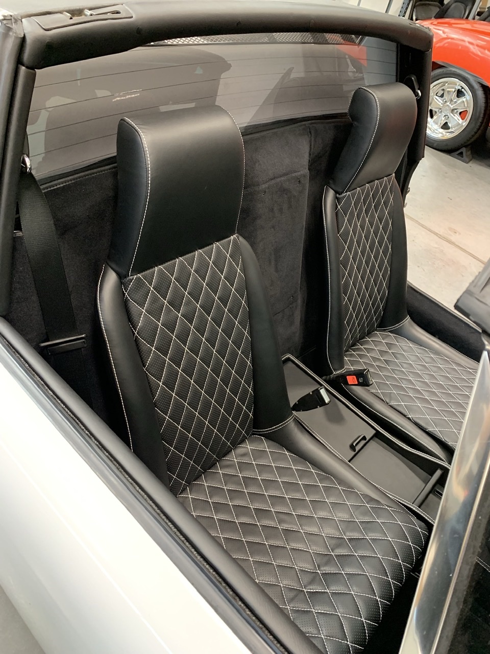

Remove the back pad, make the cut then recover. Can’t even tell.
