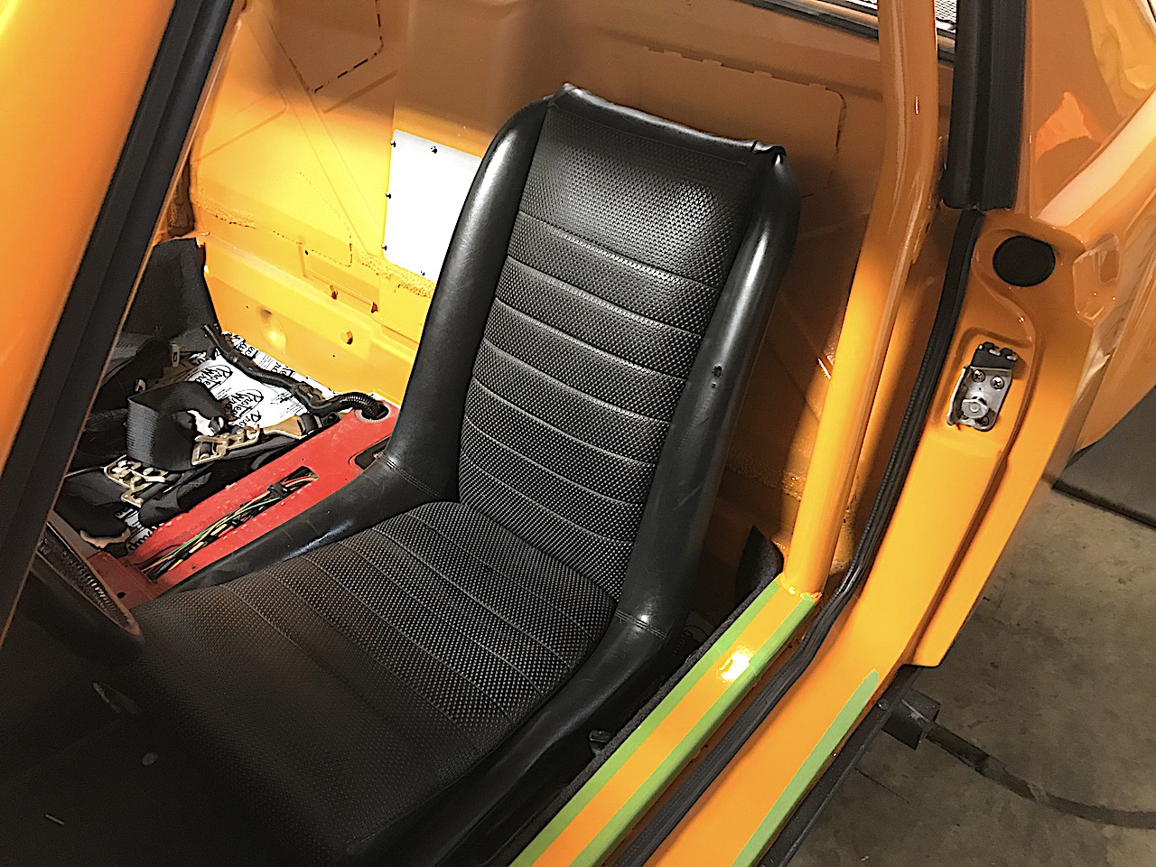

I get it Clay. But remember your only one rear glass away from you engine. You can put a small engine access in for belt and timing and cover it well fore and aft. Best, MarkAttached Image
