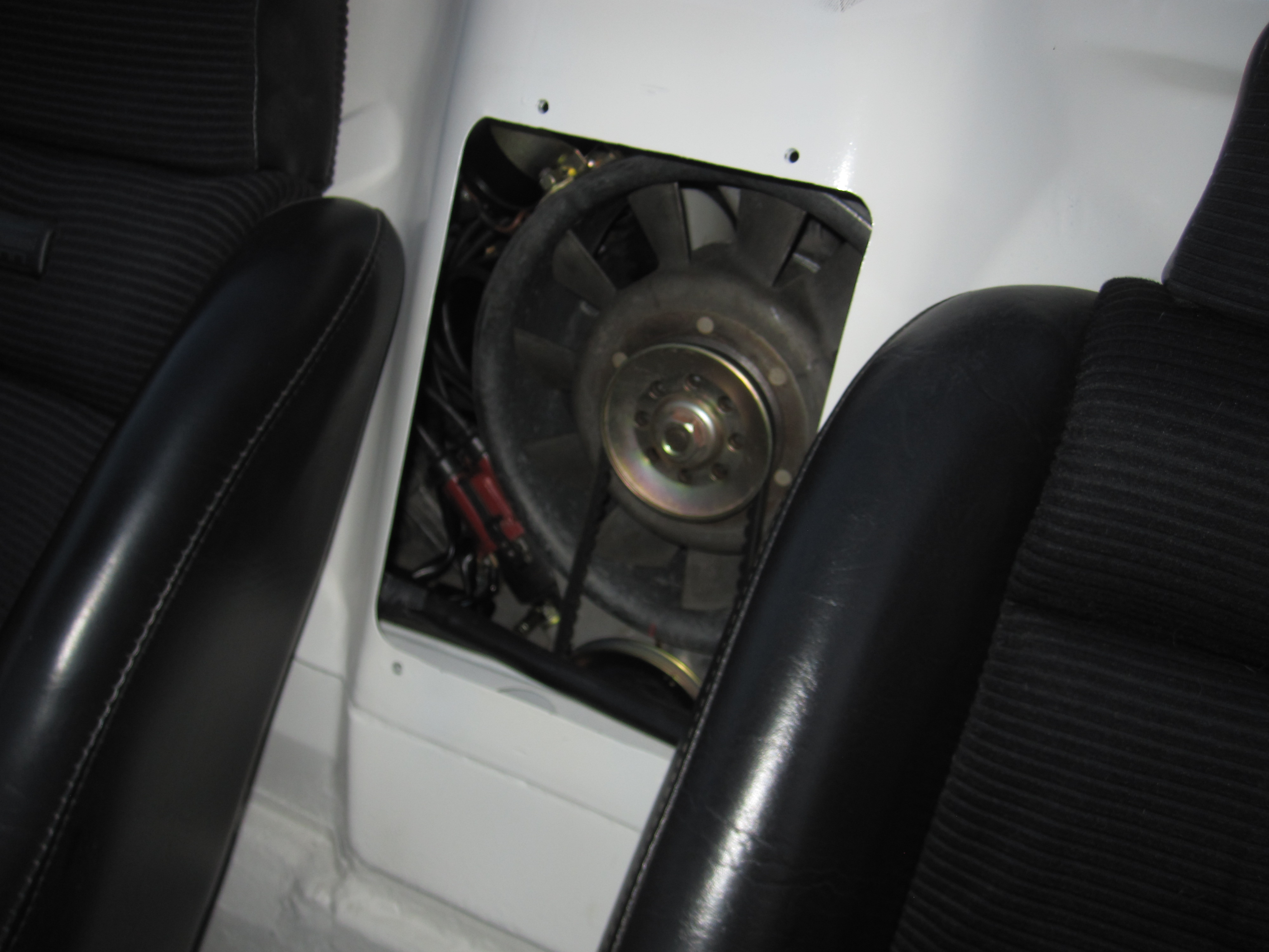

I have a car with an access and a car without.
With is certainly very convenient.
But there is no reason to poke a hole in an otherwise good condition stock
car ...... 914 4 or 6......gratuitous picture
