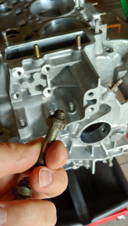

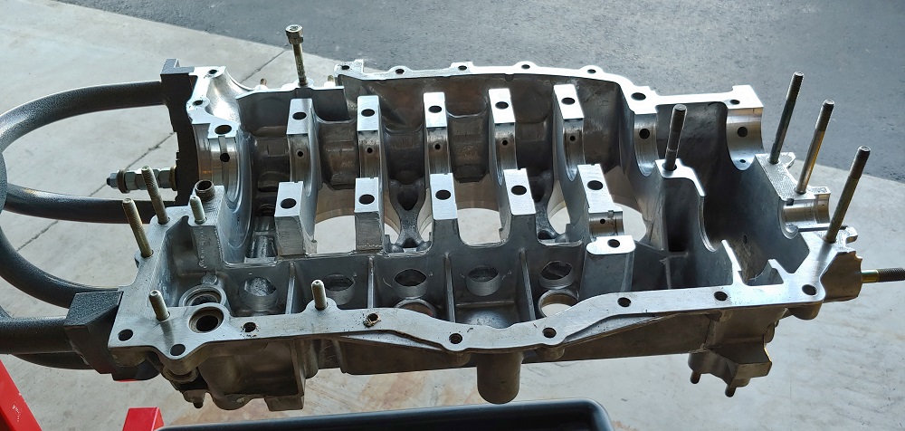

Getting the case ready to assemble. I have all the parts back from the machine shop and last of the back ordered parts are in. I didn't want to remove the outer perimeter case studs to clean the case halves mating surfaces.So I checked a few studs and they came off easily. The case cleaning must have compromised the loctite so all are coming off now to be safe and while I'm at it cleaning the mating surfaces.
Anyone know why Porsche went with the oval locking nuts on the later engines?
I have the nylon lock nuts but not the oval lock style.

Luke M   Getting the case ready to assemble. I have all the...   Oct 24 2020, 01:45 PM
altitude411   Anyone know why Porsche went with the oval lock...   Oct 24 2020, 03:35 PM
