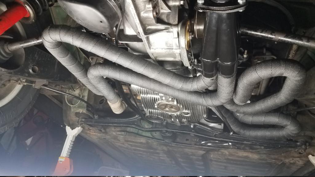

AZBanks   Since the exhaust is off while the trans is out, I...   Oct 20 2020, 02:28 AM
AZBanks   Nothing like a professional wrap job.   Oct 20 2020, 02:30 AM
AZBanks   Yeah, really, this is NOTHING like a professional ...   Oct 20 2020, 02:31 AM
VaccaRabite   Why did you wrap it? That wrap holds oil and greas...   Oct 20 2020, 07:27 AM
AZBanks   Why did you wrap it? That wrap holds oil and grea...   Oct 20 2020, 01:47 PM
