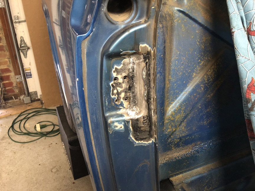

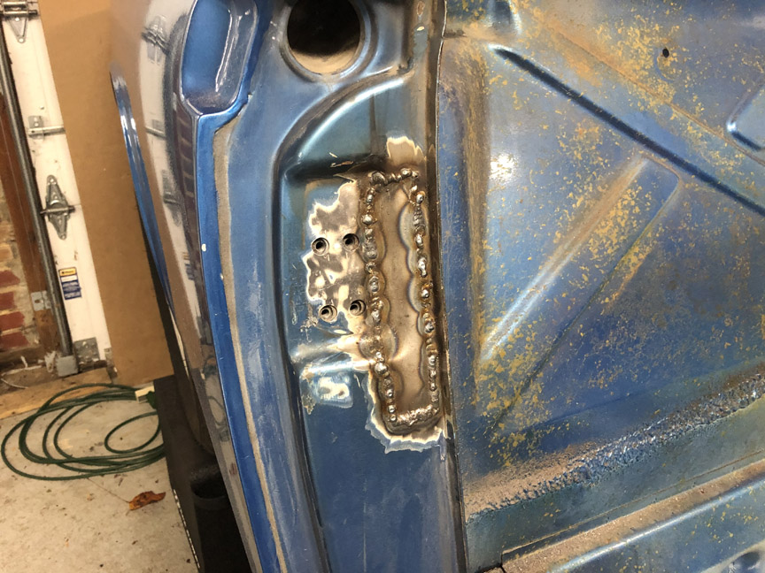

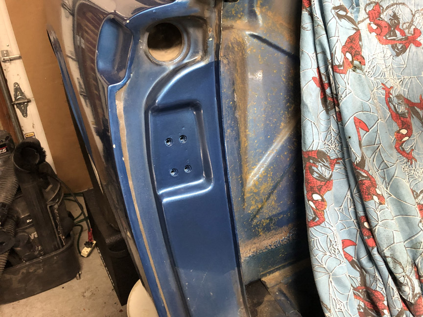

I was able to spend some time with the car this weekend, and I finished the passenger-side latch panel.
Here's the patch fully welded in:
Here's the patch ground down:
Here's the patch filled, primed and painted:
Not the prettiest job, but it will work until I have a chance to do a full restoration some time in the distant future.
