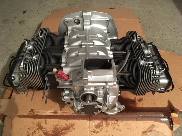

So when my 1975 1.8L overheated and failed with low compression I was looking for a way out to get back on the road fairly quickly. I settled on a SCAT 2056 long block with a WEB 73 cam, 42x38 heads and 8.5 CR. The plugs are in the 1.8L position but that allowed me to re-use my engine tin. The car has been a joy to drive especially after I added a Derale oil cooler. The temperature gauge stays way on the left side of the safe zone.
I have SSHE's and a Triad muffler so it's probably around 120 HP. My objective was a reliable car and I probably have 3000 miles on it since the conversion with no drama. The L-Jet works great as I was able to tune it with the AFR meter I had installed on the Triad.
I know there are more exotic ways to get to a 2056. I get it, but it would have been my first engine build with a good chance of getting it wrong. (Or I could have spent another $4000 for all the trimmings.) I still have the 1.8L core in case I want to go back to stock.
The best part was that the long block only set me back $4670 plus $320 shipping to Michigan.
