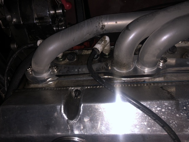

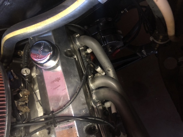

Decided I was going to do the Audi 01E install after WCR so now I need to throw some engine work in too. Probably won’t completely change gears at this point (so to speak) but it is a good opportunity to do some more with the motor at the same time.
Guesses on what happened before I tear into her? Symptoms that I know of:
-Oil leaking about a quart per 100 miles as described in previous post
-Engine running rough, underpowered, and backfire on right exhaust side
-when hard on or off accelerator oil spraying out and making it out engine lid and then to rear trunk (IMG:style_emoticons/default/blink.gif)
-does not appear to be coming out of passenger side breather although in the same vicinity.
-Radiator fluid no longer pure antifreeze color, looks dirty, but not leaking and not overheating

FL 000   Alright here’s the next clue from the first peak...   Nov 14 2020, 02:37 PM
76-914   Damn. So many possibilities. Where is the origin o...   Nov 15 2020, 10:06 AM
FL 000   Damn. So many possibilities. Where is the origin ...   Nov 15 2020, 05:38 PM

Rider914   Wow - Did you cross your oil cooler and water cool...   Nov 17 2020, 02:52 PM
djway   Head gasket?   Nov 17 2020, 03:17 PM
FL 000   Alright it turns out the heads were jacked up. Too...   Jan 8 2021, 08:11 PM
FL 000   So put my heads on tonight and adjusting the valve...   Jan 8 2021, 08:18 PM
