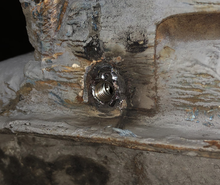

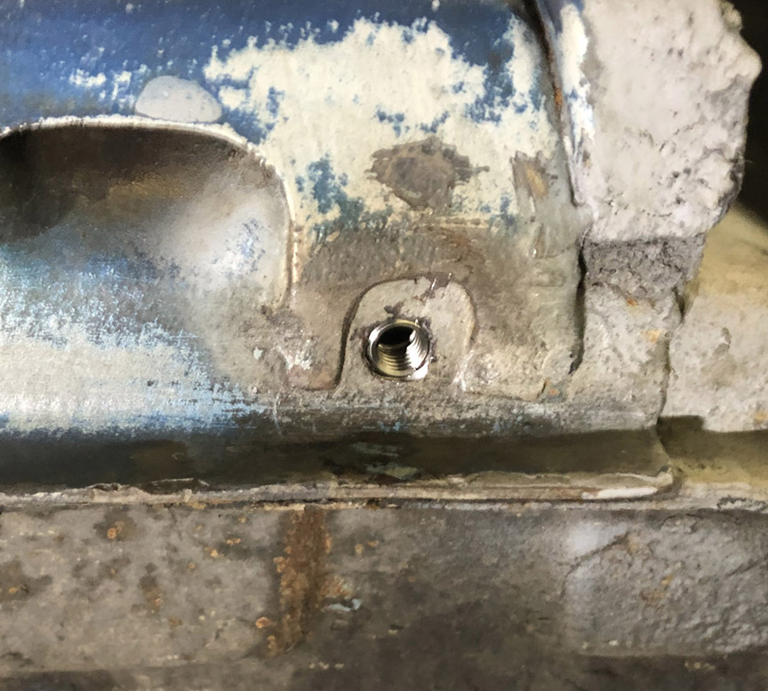

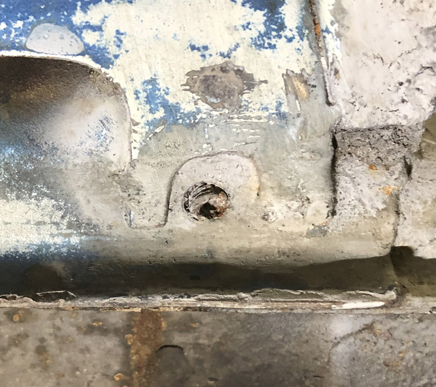

I took advantage of the federal holiday to spend a little more quality time with the car today. Today's task was to fix the six bolt holes (3 per side) used to attach the bottom side of the rocker panels. I was hoping that all I would need to do was drill them out with a left-handed bit and everything would be good, but nope, the DAPO had other ideas.
Every single hole had a broken bolt stuck in it, and every single broken bolt had a hole drilled off-center through it. Like this:
You'd think after boogering up one or two holes, the DAPO would take a step back and try to get better instructions and/or tools for this job (or an f'ing clue), but nope, they charged forward and screwed up all the holes (only one shown for brevity).
For five of the holes, I was able to use my dremel tool with a tiny carbide bit to grind out the remnants of the bolt. Then, for each hole, I drilled the hole oversize, tapped it and installed a helicoil.
However, one of the DAPO-holes was so far off-center, I had no choice but to grind the hole oversize and weld it up. I then drilled, tapped and installed a helicoil in this hole so it would be consistent with the others.
