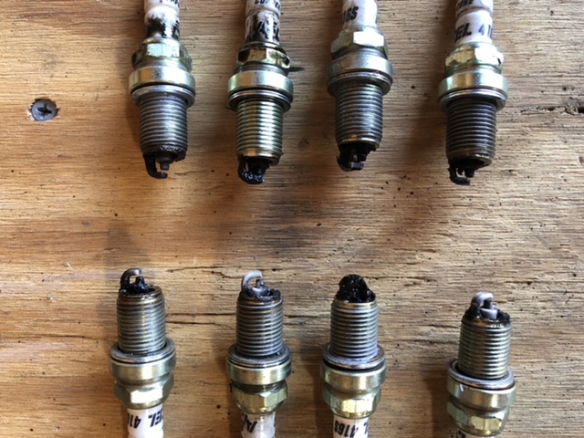

Alright here’s the next clue from the first peak inside the engine. These are “new” and have about 1000 miles on them. (IMG:style_emoticons/default/blink.gif)
Bottom left on pic is front driver side for reference. The rest are in order.

FL 000   Alright here’s the next clue from the first peak...   Nov 14 2020, 02:37 PM
76-914   Damn. So many possibilities. Where is the origin o...   Nov 15 2020, 10:06 AM
FL 000   Damn. So many possibilities. Where is the origin ...   Nov 15 2020, 05:38 PM

Rider914   Wow - Did you cross your oil cooler and water cool...   Nov 17 2020, 02:52 PM
djway   Head gasket?   Nov 17 2020, 03:17 PM
FL 000   Alright it turns out the heads were jacked up. Too...   Jan 8 2021, 08:11 PM
