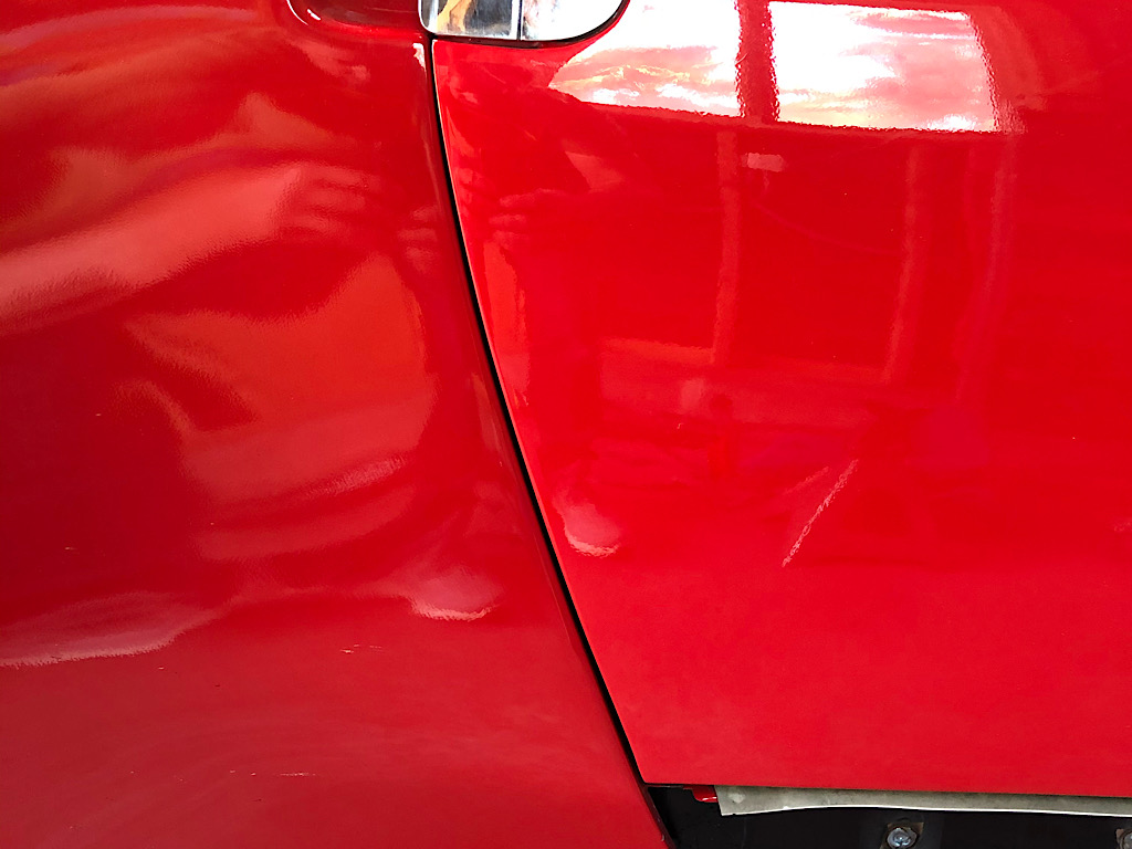

Well that sucks. Got passenger long reinforcement welded in with gap set as desired and this was the result with weight on wheels. Not sure how evident it is from picture, but gap closed up quite a bit. No more rubbing so I guess that is good.
Door is functional so going to put problem to back burner again. Short of a frame bench I think a roll cage may be my only at home solution at this point. Don’t really want a roll cage so need to ponder on it for awhile.
The longs do the majority of the work keeping the door gap set, so I wonder if my flex is happening in the metal above it, with the shock being the lever to bend it all forward. (IMG:style_emoticons/default/idea.gif)
How is the front gap? It is possible to shift the door forward slightly, with a bit of persuasion of the B-pillar hinge mount spots (with a block and hammer and feeling brave).
I have always been one of those guys that over tightens, over bends, etc so to be honest I am afraid to try to push too much on the hinge side (IMG:style_emoticons/default/biggrin.gif)
With that said I have done some of that with a hydraulic ram and some lifting on the door but the front gap is pretty good so figured I would leave it alone...at least for now!
