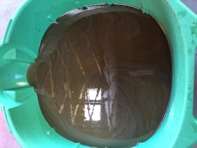

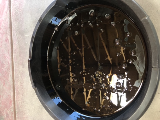

QUOTE(76-914 @ Nov 15 2020, 08:06 AM) *
Damn. So many possibilities. Where is the origin of the oil leak? So many fouled plugs, too! Have you done a leak down test yet? Sounds like a head gasket leak between the water & oil passages but not between the cylinders. The odd thing is fouled plugs on both sides. 0 chance of blowing head gasket on both sides or cracked heads on both sides unless it overheated but you'd have noticed that. Looking forward to seeing what you find when you tear it down. (IMG:style_emoticons/default/beerchug.gif)
No leak down test yet but may once I get the engine and trans removed. I did a compression test before WCR and all were in the 150 psi area. Guessing that isn’t the case now (IMG:style_emoticons/default/lol-2.gif)
Here is the oil and coolant; kind of hard to tell which is which right?! The coolant was a nice green last I checked.

Rider914   Wow - Did you cross your oil cooler and water cool...   Nov 17 2020, 02:52 PM
djway   Head gasket?   Nov 17 2020, 03:17 PM
FL 000   Alright it turns out the heads were jacked up. Too...   Jan 8 2021, 08:11 PM
