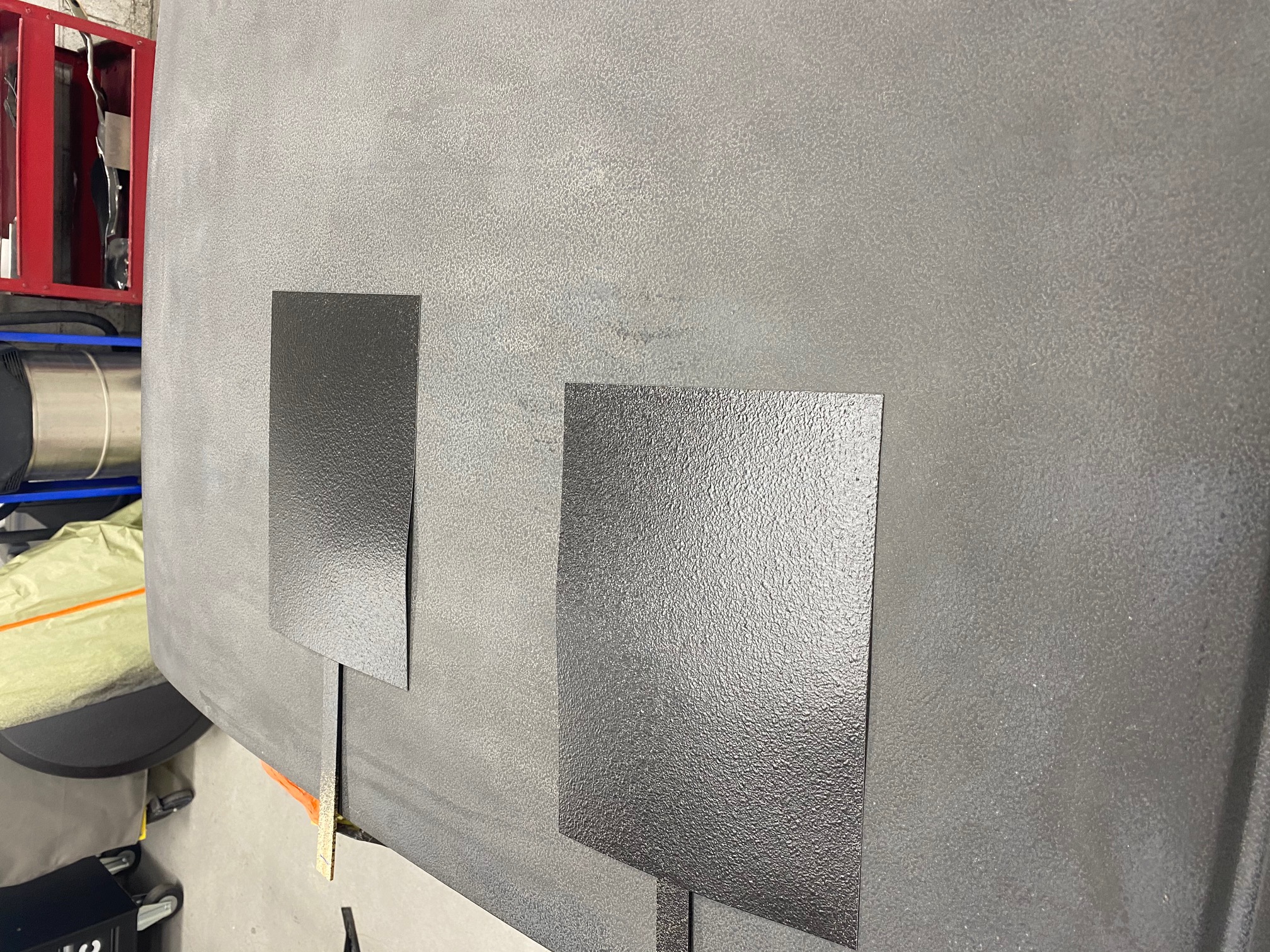

The 1st attempt was too thick IMO, so I brought them up another spare roof with factory texture and we're working on spray outs to get the Wurth SKS to the right consistency...we're getting close, I'll share whatever the magic dilution rate is when we get it exactly right

eric9144   I'm curious what you guys think, I know it...   Nov 12 2020, 07:52 PM
eric9144   The 1st attempt was too thick IMO, so I brought th...   Nov 19 2020, 09:53 AM

eric9144   Got the roof texture and color right after the 4th...   Dec 16 2020, 01:11 PM
johnhora   Eric...that looks great!   Dec 16 2020, 02:02 PM
