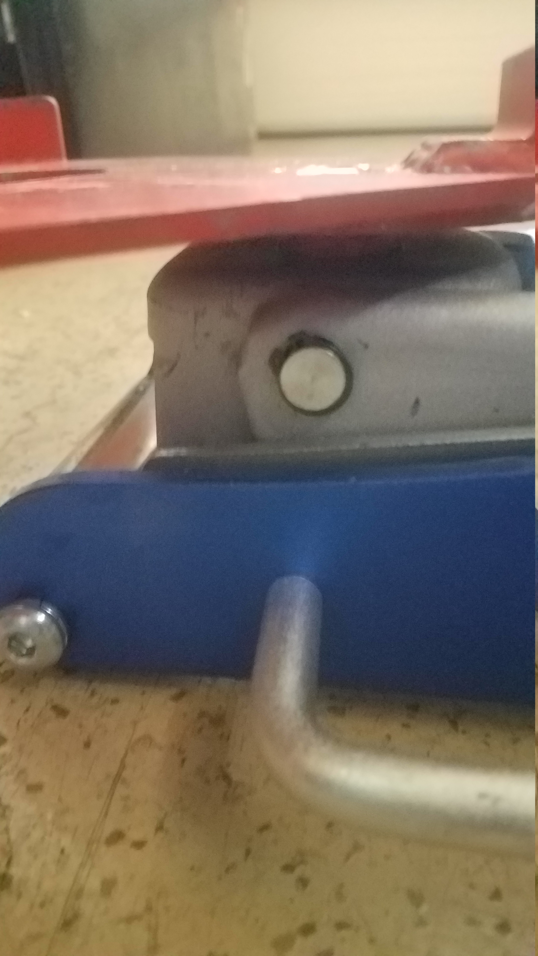

TEP on floor jack. ROCK Solid!

That’s nice work @AZBanks . My craftsman jack had a similar horizontal pin that would not allow the TEF to sit down in the hole. I removed the pin and got a couple of carefully measured bolts to us in its place. That was a tip from Chris at Tangerine.

Can you provide the Craftsman jack model number? Most new floors jacks including all the Harbor Freight ones do not have a hole big enough to accomodate the Tangerine Plate bottom bar.
The HF jacks have a removable swivel plate that is held in place by a big allen shoulder screw (hidden under the rubber pad). My newer engine lift plates are designed to be held in place with that shoulder screw.
