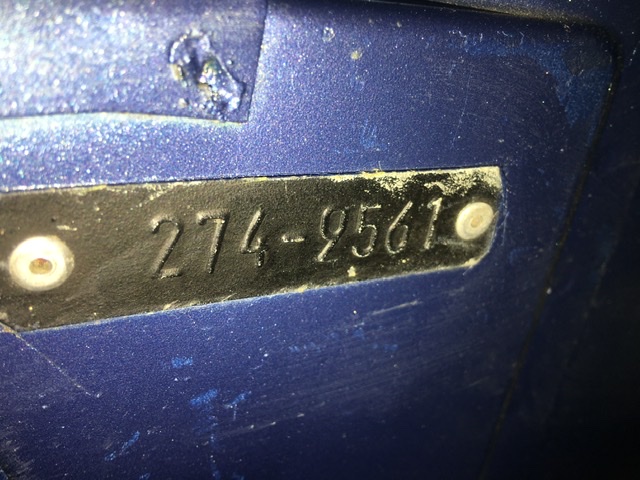

Found this tag on the ABM
Chassis born on July 4th 1974
