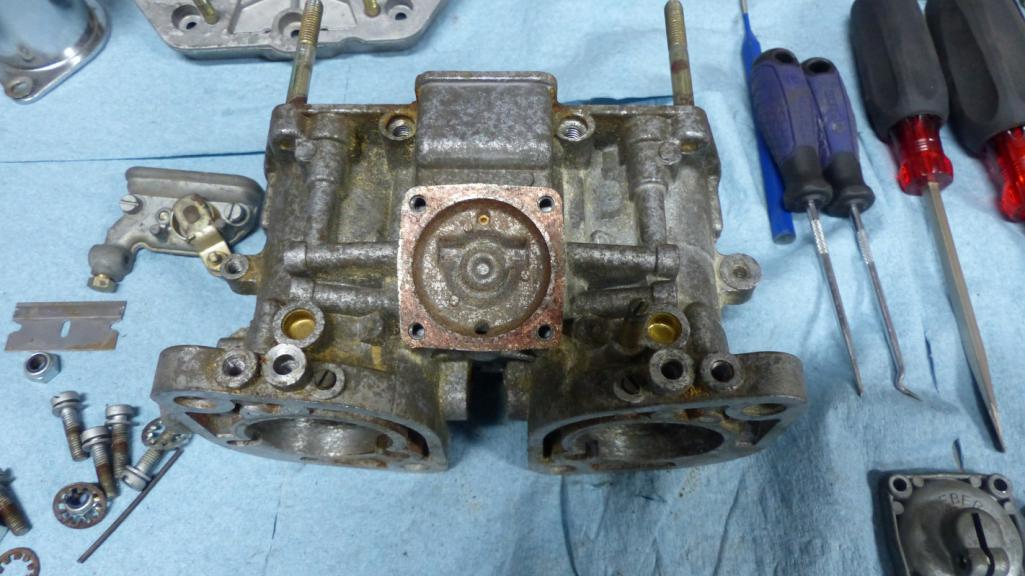

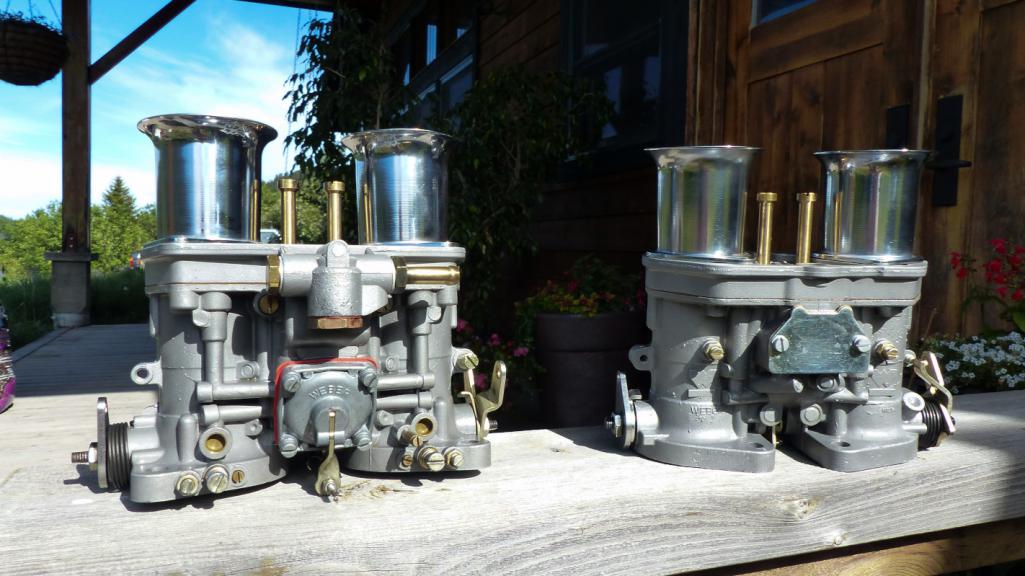

Brent’s carbs. I had to go easy because I didn’t want to strip off the plating on the hardware and fittings. Still, it looks better than what we started with and I was happy I could help out Brent. A little payback for such an entertaining and enjoyable build thread.
*I don’t do this for hire and since I no longer work at the shop, I’m not able to sneak in other peoples parts. Sorry.
The good thing is that there are more and more people offering this surface.

mepstein   Brent’s carbs. I had to go easy because I didnâ€...   Nov 22 2020, 08:10 PM
bbrock   Can't tell you how grateful I am that you brou...   Nov 22 2020, 10:54 PM
