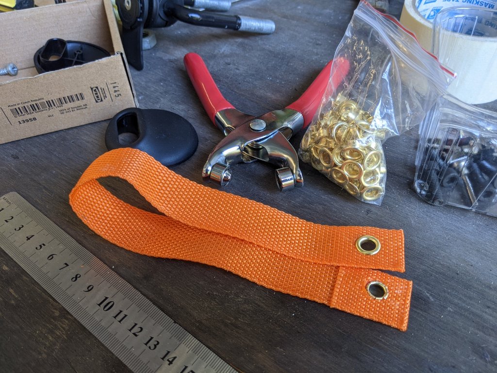

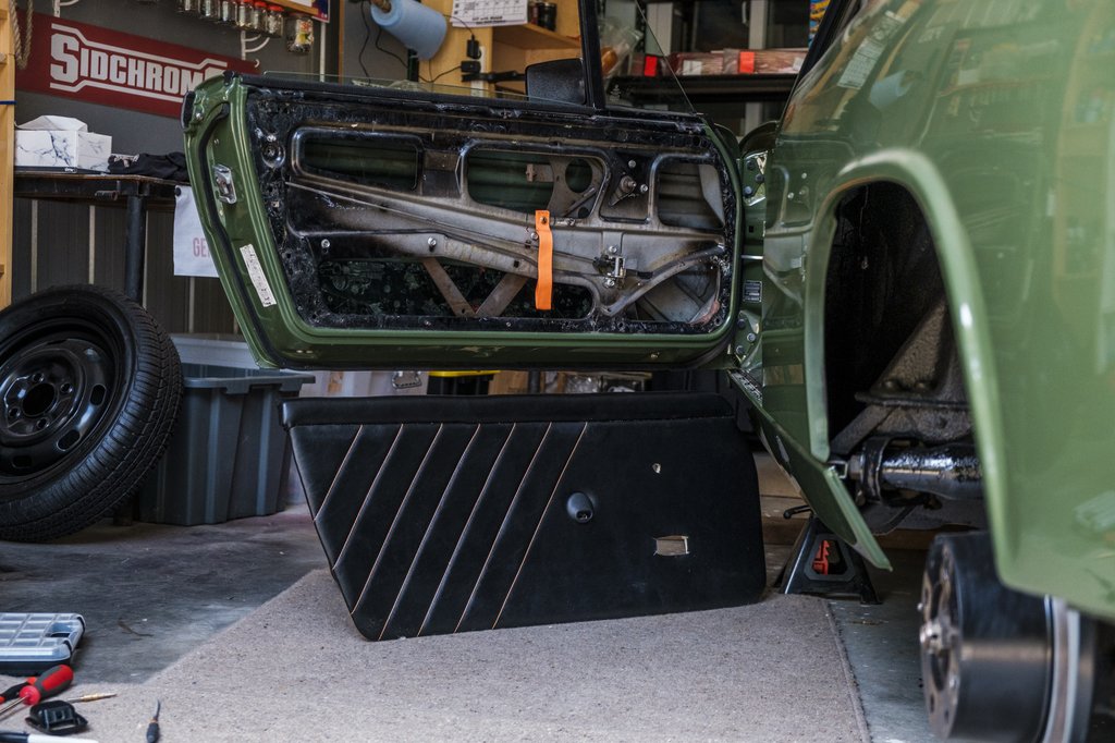

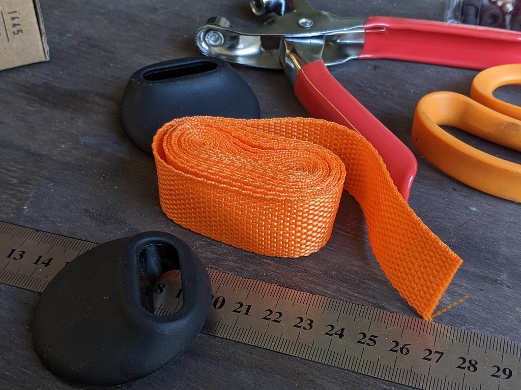

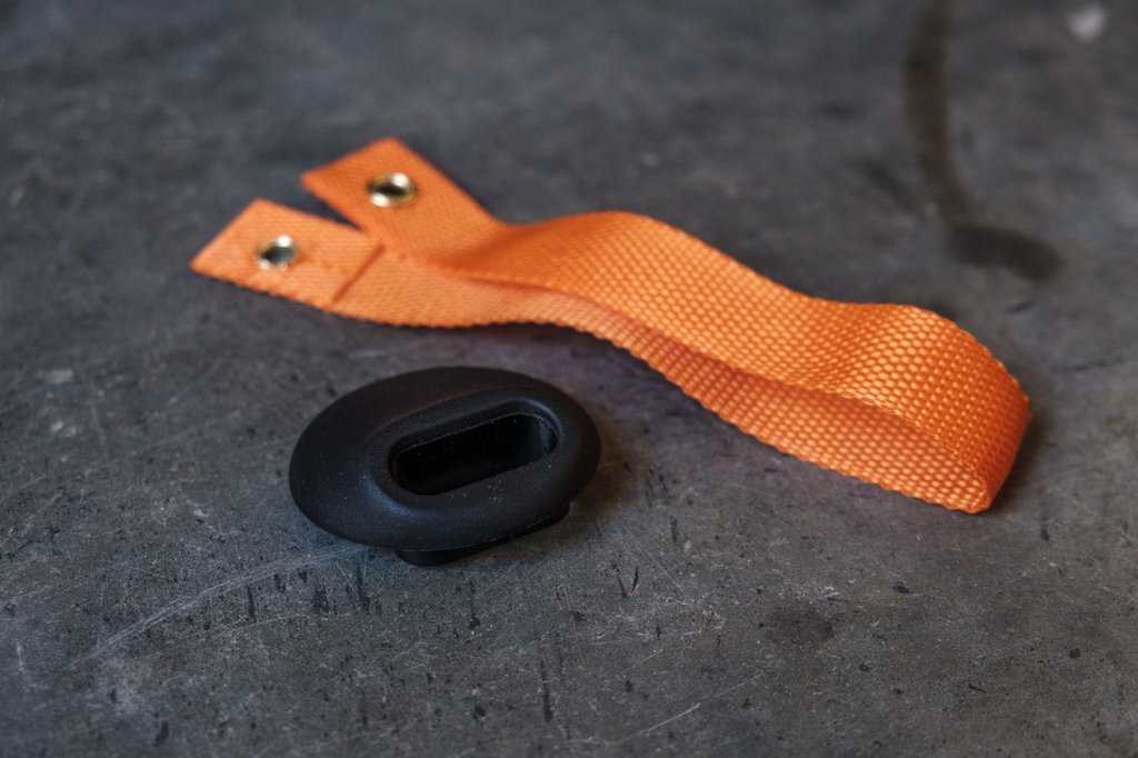

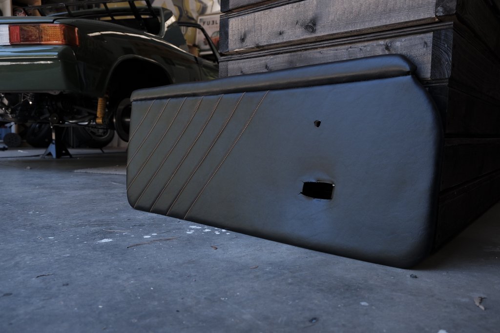

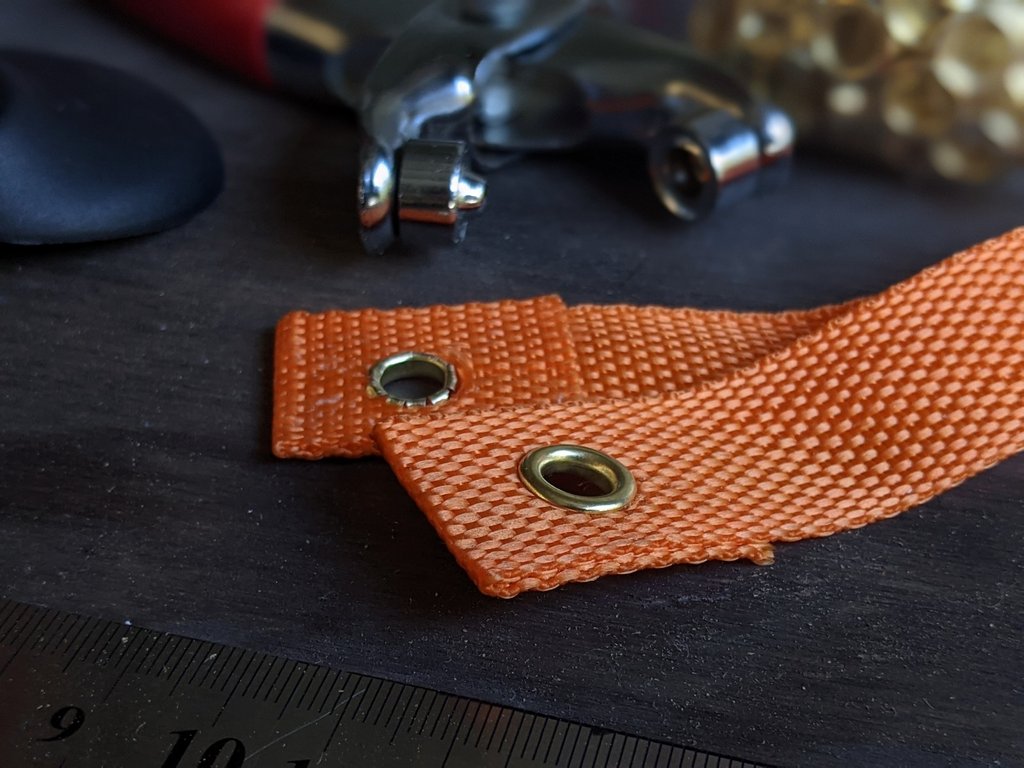

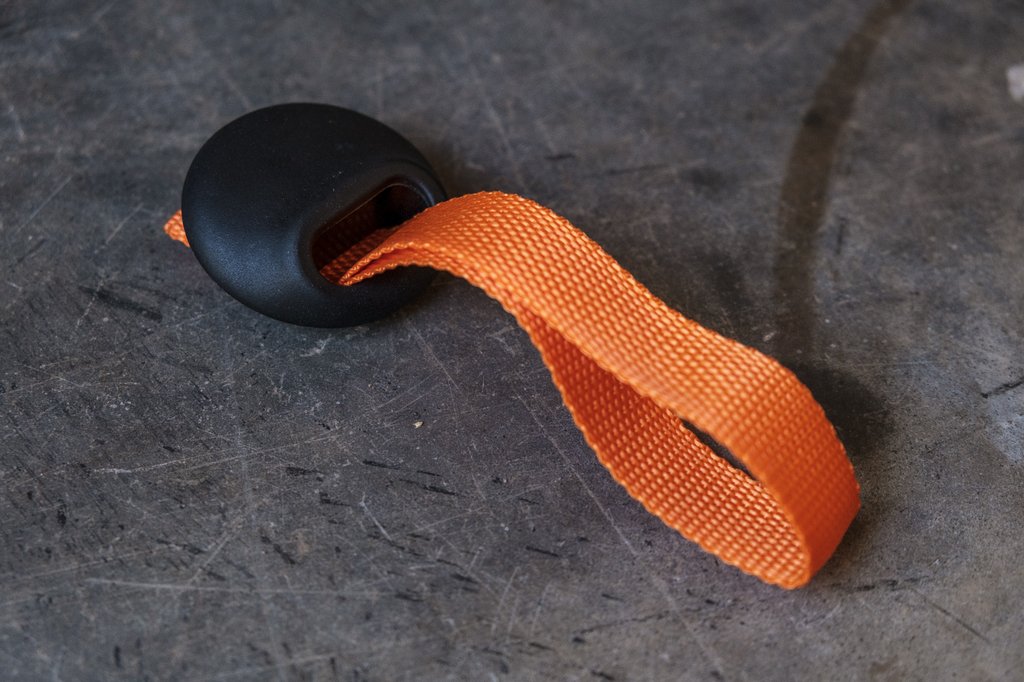

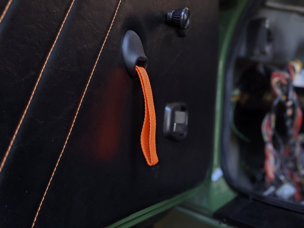

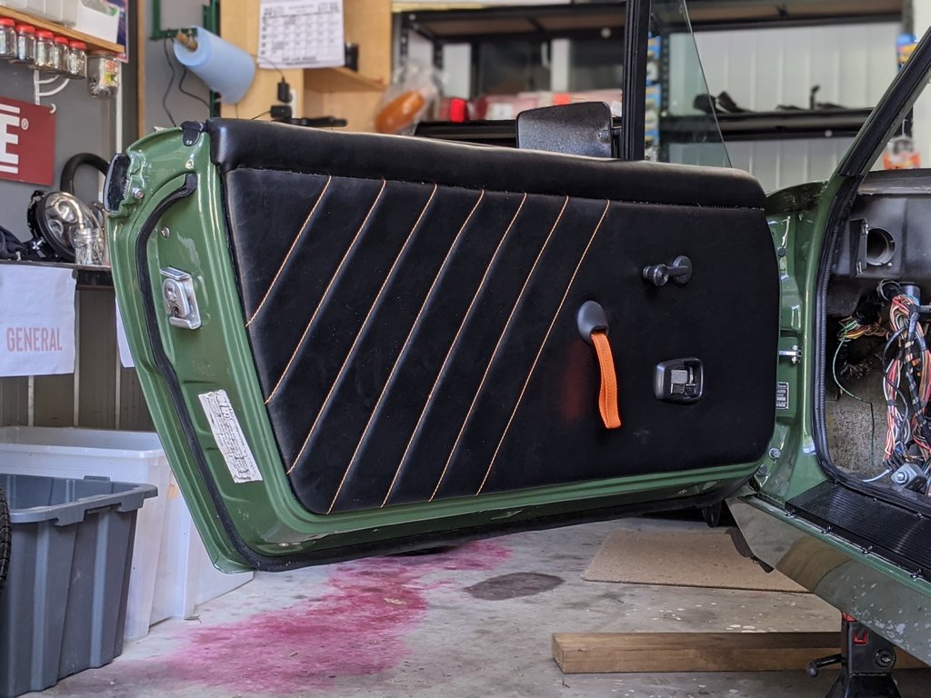

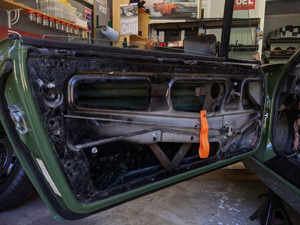

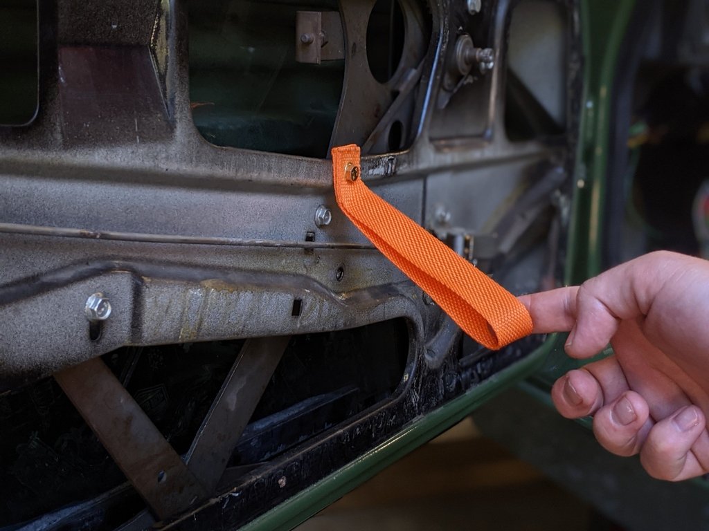

I made a start on the door cards today. Matt from 914 Rubber supplied me with some plain door cards last year that he custom stitched in orange for me. Today I got round to making up some RS-style door pulls. I used a roll of orange webbing and a craft eyelet punch tool. I then drilled into the door casing and mounted the loop with a bolt.
I cut a hole in the new door card and threaded the loop through, finishing off with genuine 911 RS plastic pull loop escutcheons.
The main difference with this method to regular 911 RS pulls is that mine pulls the door closed, whereas they open the door. This method is more in line with my skill level as I did not want to get into mounting the loop to the opening mechanism.
Thanks for looking.
