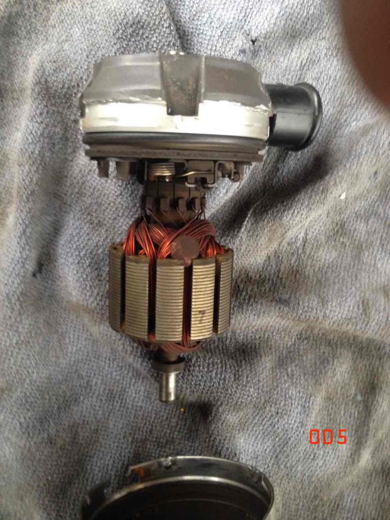

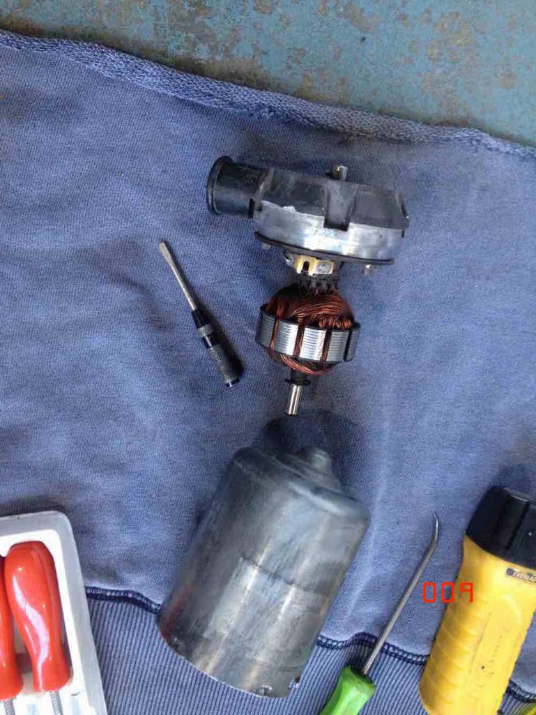

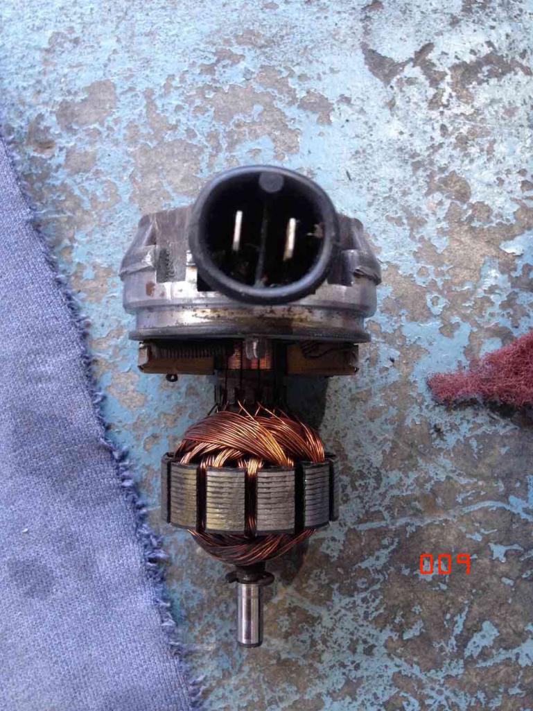

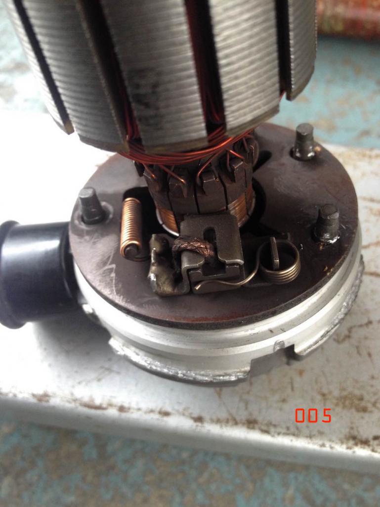

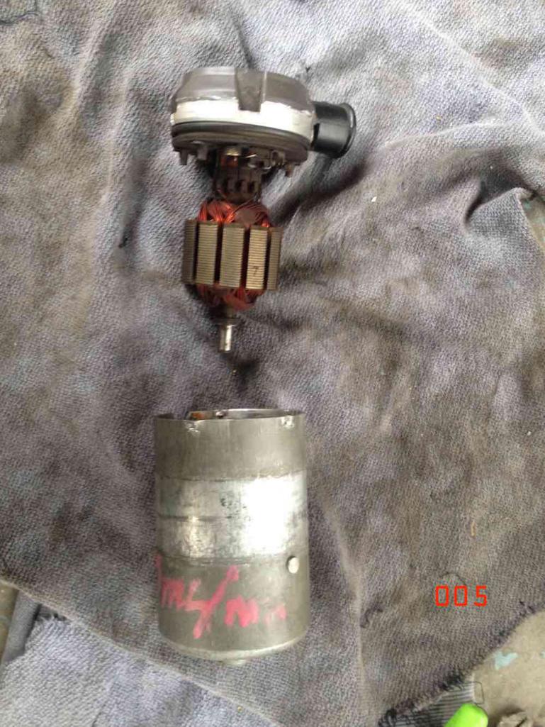

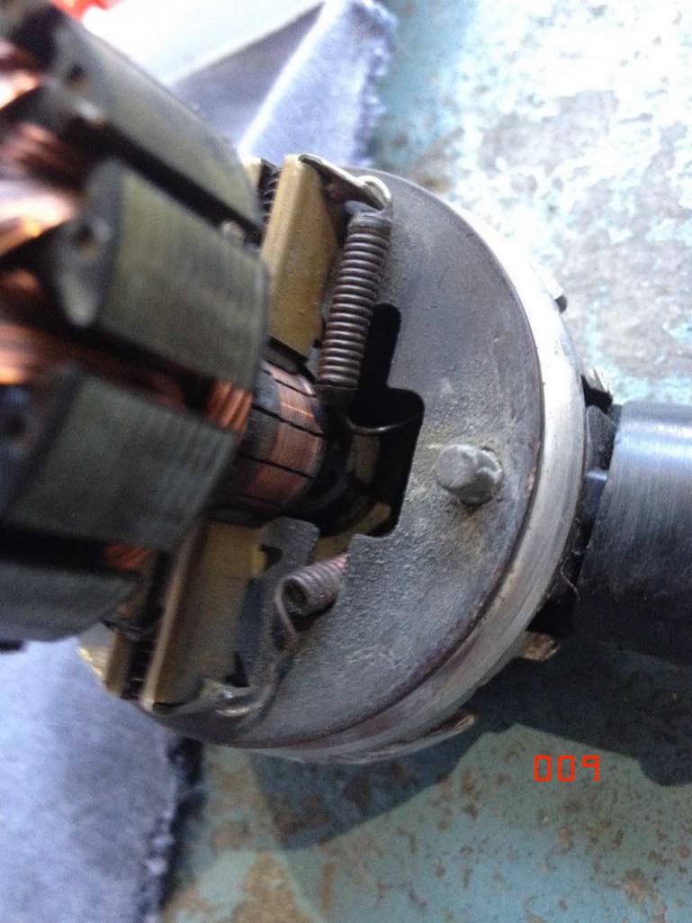

005 Pump.
Disassembled the 005 pump today. Getting better, all apart in about an hour.
The top part of the pump is identical to the 009 unit.
The motor itself is where the differences are.
The armature section (electro magnets) and interior permanent magnets (Fixed to the pump casing) matches the dimensions of the older and earlier mercedes fitted unit but lacks any "turbulence" shrouds (if that is what the shrouds are). In the 009 unit that supersedes it the armature section has smaller sized electromagnets.
The plate holding the brushes and spring wires connecting to the electrical plug is closer to the earlier mercedes fitted unit in layout and components.
Basically the internal components are being miniaturised and reduced in size from 005 to 009. I haven't measured all the different components but the external casing of the 009 looks slightly shorter in length than the earlier 005.
The reason that the 005 has come apart is that it was delivering insufficient flow when tested. at first glance visual inspection we can't seem to find any obvious reason for that. the motor and internals are in the same condition (very good) as the 009 pump that came out of my 914. The 1974 SAAB EMS it was fitted to had done approx 80,000km (50,000 m). The pump came out of the SAAB years (decades) ago and has been stored since.
Comparison images.
