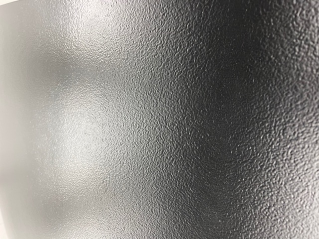

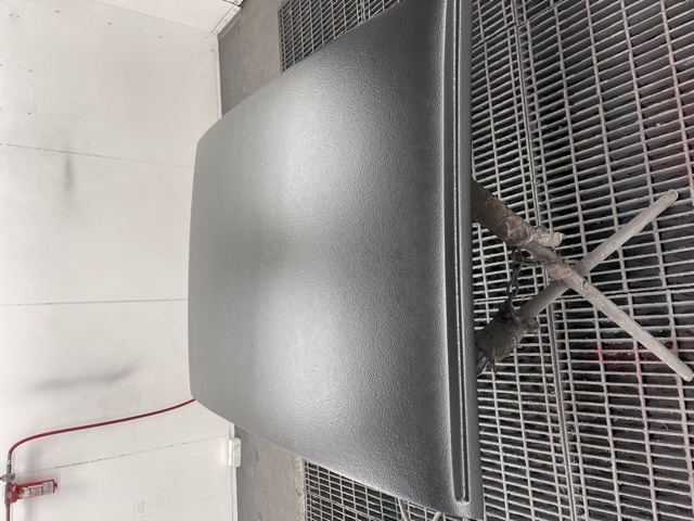

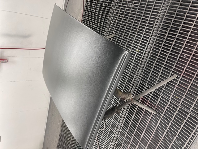

Got the roof texture and color right after the 4th attempt (IMG:style_emoticons/default/beerchug.gif)
Was harder to get the texture dialed in than I expected, had to be thined down a bunch and then knocked down at the end slightly to get it right.
Ordered up new rubber and a headliner from 914rubber on black Friday as well as latch HW and screws from Bruce Stone, should have the roof back this coming weekend (IMG:style_emoticons/default/first.gif)
