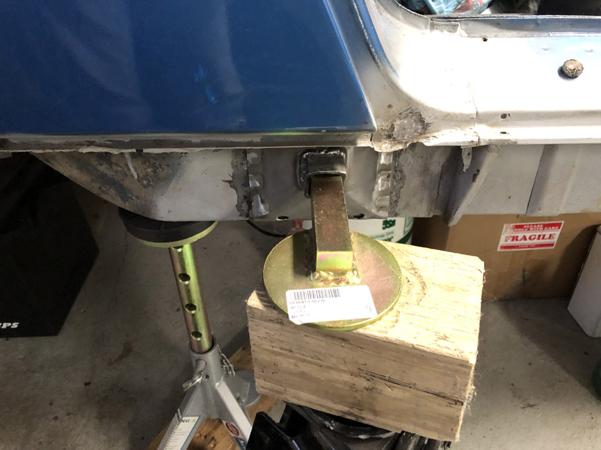

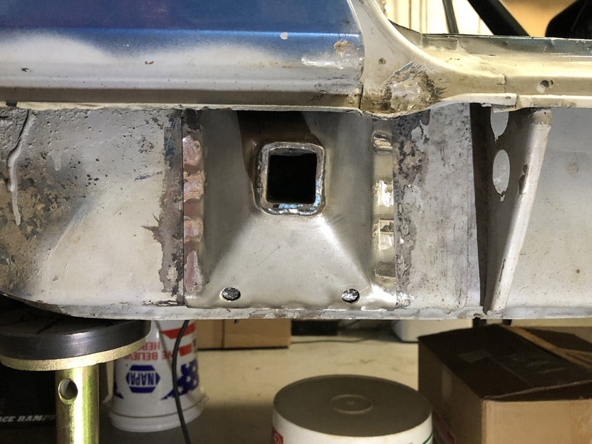

And . . . done!
It even works!
I need to finish cleaning up and painting this side, then it's on to the other side (joy. (IMG:style_emoticons/default/headbang.gif) )

QUOTE(BillC @ Dec 6 2020, 01:13 PM) *
And . . . done!
No getting off that easy. (IMG:style_emoticons/default/happy11.gif) Do tell . . . . How did you weld the top? I'm assuming MIG with blind point & shoot approach?
I've got a similar situation but will need to TIG. I'm really debating about removing the top 1/2 of the pyramid. I want full fresh metal in there but I think it's going to be almost impossible to weld the top. Having said that the welds along bottom and side would be more than enough to provide a functional support. Maybe just seam seal the top and be done with it. (IMG:style_emoticons/default/idea.gif)

QUOTE(bkrantz @ Dec 20 2020, 10:16 PM) *
And I agree: grad school sons are sometimes helpful.
Yup, especially when they figure out how to pay for grad school on their own! In this case, he has a research assistant position that includes tuition and pays a stipend that covers room and board.
QUOTE(Superhawk996 @ Dec 21 2020, 10:01 AM) *
And . . . done!
As you guessed, I used a MIG welder. I pre-drilled all the rosette holes, then one-at-a-time, positioned the MIG gun over each hole and filled in the spot. I used the goggles from my acetylene torch, since I couldn't get my head in position to see while wearing the welding helmet -- it was a little bright, but much better than no protection at all. I did the top after doing the sides and bottom, so I didn't have to worry about the piece moving while welding.
Rather than just seam-sealing the top of your pyramid, maybe you can TIG the sides and bottom and then MIG weld the top like I did. Ugly welds hidden where no one can see should be better than no welds at all.
