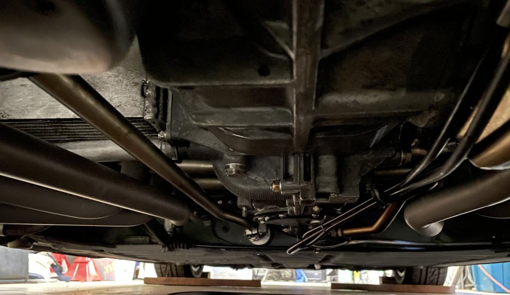

Follow up: so the new front link rod arrived from @mepstein - many thanks Mark - and fits the Tangerine Racing bushing perfectly. So after some analysis and re-engineering, am happy to report that shifting is now possible again!
The rear linkage I bought from PMS (I guess) was intended for later cars, and the alignment of it in my car never really looked right. I ended up re-drilling the shift cup alignment hole, effectively "clocking" the rear linkage by 90deg, which made all the difference. Clearances to a couple of spots on the engine were close before, now much better.
Some pics (I should have taken before I took it off the axle stands <slaps forehead>):
Back on the road. Thanks to @ChrisFoley and all who contributed.
- Tony
