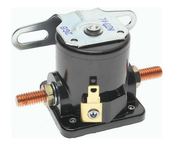

Not to beat a dead horse but I found this solenoid. It's 12 volt and comes with a slide terminal to match the wire coming from the ignition switch.
https://www.oreillyauto.com/detail/b/standa...enoid&pos=6 Attached Image
