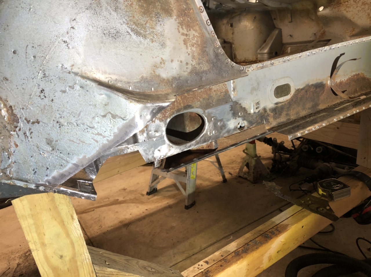

Pulled my rocker covers today to inspect for rot. Unfortunately I found significant rust on both jack points and the driver’s side long has a good size rust hole. I’m going to cut and patch the bad spots in the longs, but I’m trying to avoid a complete resto right now and I don’t want to get into exterior bodywork. The rear fenders are in pretty good shape but they seem to block access to the top flange of the jack point plate. Does anyone know if the jack points can be replaced correctly without cutting out a lower portion of the rear fender?

I’ve been chipping away at this project over the past couple of weeks and have made some progress on the passenger side repairs. As with any project like this, there has been considerable scope growth... one thing I am now considering is the addition of a inner long stiffener kit from Mad Dog Motorsports. I figure, since I’m here, now is the right time to do this... the question I have for all of you is, when should I install the stiffeners? Right now, I am just about ready to close up the passenger side long with the new inner rocker panel from RD. Before I do this, I want to coat the inside of the long with something for rust prevention. If I weld on a longitudinal stiffener after I coat the inside, some of the coating will burn off, but if I install the stiffener before I close up the long, I’m worried about warpage. Which is the lesser of the two evils? Anyone have any thoughts?

Don't know if you ever did this, but some of us have used Eastwood's Internal Frame Coating to protect internal channels and in the center tunnel area.

IronHillRestorations   You'll probably have to cut a section off the ...   Mar 10 2020, 04:44 PM
dlee6204   It is possible to replace the points without cutti...   Mar 10 2020, 05:38 PM
flyer86d   I’ve done it by cutting out the lower couple of ...   Mar 10 2020, 05:59 PM
Superhawk996   Uh, what what do you intend to weld to? Can’t w...   Mar 10 2020, 07:07 PM
bbrock   Yeah.... I'm afraid you are beyond being able ...   Mar 10 2020, 07:13 PM
cary   Yes you can. But you can only do 3 rosettes on the...   Mar 11 2020, 08:45 AM

Superhawk996   Just a slight amendment to this. They should ha...   Mar 11 2020, 05:47 PM

brant   cut the fender and repaint... welcome to the typi...   Mar 11 2020, 09:28 AM
bkrantz   cut the fender and repaint... welcome to the typ...   Mar 11 2020, 07:57 PM

dr914@autoatlanta.com   NEVER cut the exterior sheet metal!!!...   Mar 11 2020, 09:30 AM

Lilchopshop   Thanks to all for the responses and opinions (neve...   Mar 12 2020, 05:55 AM
jagalyn   Everything else looks really good... Seeing the ye...   Mar 12 2020, 06:31 AM

Superhawk996   I can always appreciate someone willing to save an...   Mar 15 2020, 12:50 PM
Lilchopshop   So, this happened this week... going full restora...   Mar 19 2020, 06:00 PM

bbrock   Yes sir! Good job. It's clear that you m...   Mar 19 2020, 07:10 PM

rjames   Hard to tell, but it looks like the jack stands yo...   Mar 20 2020, 10:18 AM
Lilchopshop   Peeled back some more of the outer long so I could...   Mar 21 2020, 04:08 PM
Lilchopshop   Scrolling through YouTube this morning and found t...   Mar 22 2020, 07:34 AM
Superhawk996   Yup, that hidden rust at the seat belt anchor coul...   Mar 22 2020, 07:46 AM
