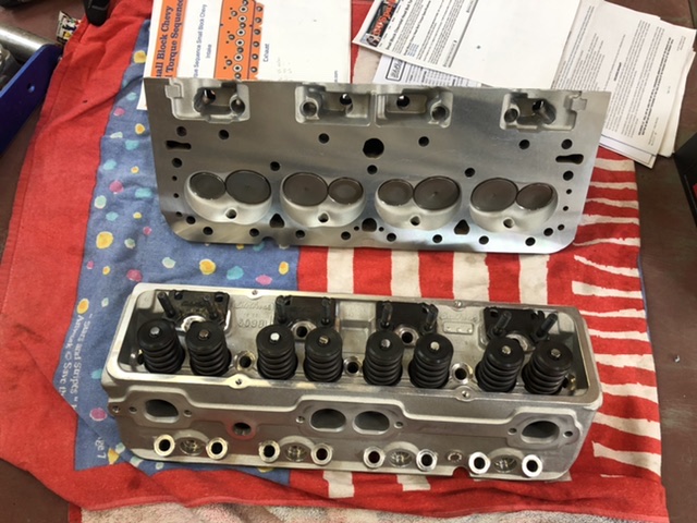

Alright it turns out the heads were jacked up. Took it to my local machine shop and they went through them both. The said tons of carbon deposits on the intake valves. All the valves and guides checked good, so they basically just gave it a valve job and replaced the seals. I wouldn’t have thought valve seals alone could cause the oil consumption I was seeing, but I have a lot of confidence in the shop so assuming they are good now.
Sure look nice all cleaned up.
