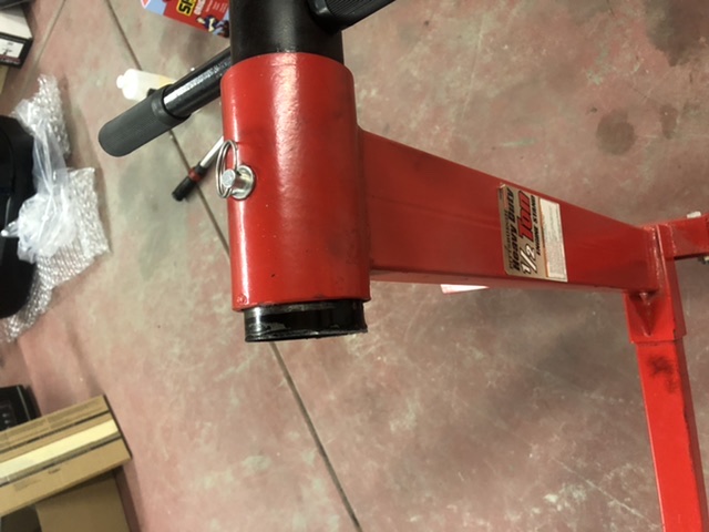

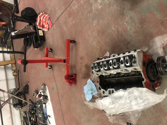

So put my heads on tonight and adjusting the valves and this happens (IMG:style_emoticons/default/headbang.gif)
Yeah, rotating crank and engine literally falls off the stand without warning. Luckily didn’t land on me or my feet. Base of stand took initial impact and then it fell final few inches to the ground. Scary.
Too upset to assess damage tonight so will get it in the air tomorrow. Just curious if this has happened to anyone else before?

rhodyguy   WOW! That could have been a life changing even...   Jan 8 2021, 09:13 PM
djway   Holy Crap. What brand is that stand? Glad you stil...   Jan 8 2021, 09:28 PM
FL 000   Holy Crap. What brand is that stand? Glad you sti...   Jan 9 2021, 10:14 AM
808 WRX   Glad your feet are ok! Hope the motor is ok t...   Jan 9 2021, 10:48 AM
djway   Holy Crap. What brand is that stand? Glad you st...   Jan 10 2021, 01:39 AM
76-914   Aww Man. Sorry dude. I've got one of those but...   Jan 9 2021, 10:24 PM
cali914   You are lucky from the head situation and the acci...   Jan 10 2021, 01:29 AM
Andyrew   Wow that is nuts with the engine stand! I have...   Jan 10 2021, 01:33 AM

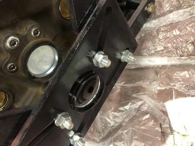

FL 000   A couple more pics that may help some of you with ...   Jan 10 2021, 10:53 AM
