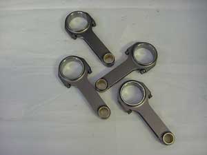

I'm starting to get the case(s) machined and inspected and parts ordered for my next generation engine. The car is mostly used for autocross.
78x96
96mm piston with 22mm wrist pin (stroker)
5.4" Type 1 Rod, 22mm wrist pin
WebCam 86b/86c
David Finch heads (from Len Hoffman many moons ago)
9.5:1 CR running on 91 octane pump gas
CB Dry Sump (heavily modified) or Thorsten Piper dry sump pump
Front mounted oil cooler
There are a few crank options out there now:
* DPR offset grind Type 1 journal
* AA Performance Forged Type 1 journal
* FAT Performance Forged Chevy journal
I've read about a few 80mm DPR cranks breaking, so I was planning on staying under 80mm as I like the car to be able to rev. I was considering Chevy journals for ease of assembly, but the two cranks I've read about breaking were 80mm/Chevy journals. Is there any new information on cranks out there? Any input on the config?

Both 78 T1 and the Chevy rod flavors need reduced base circle cam and mod rods. All because of one pesky cam lobe in the way.

Reduced base-circle cam OK, but do these types of rods also need rework?

Yes, it's not a huge amount but there's still a bit of clearancing, if you buy rods from T4store this is already done. For chevy rod and 80mm you have way more rod clearancing to do than the T1 rod.
I use the CB rod for 78mm T1 and the SCAT rod for 80mm chevy.
Stroker cranks are a lot dry fitting, I often assemble an engine several times as I build. As I like to say "no two objects can occupy the same space at the same time."
