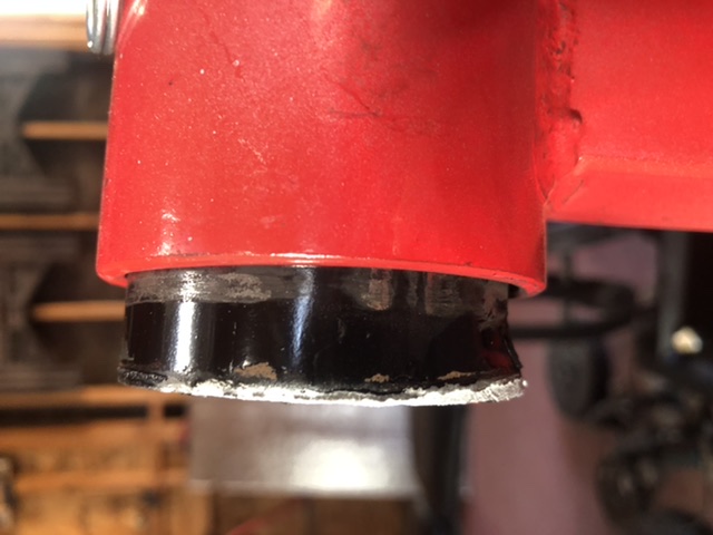

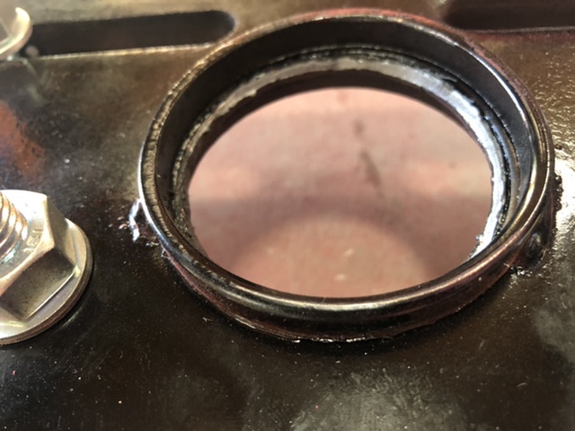

A couple more pics that may help some of you with a better eye than me. With the material still showing in the top one it does look like it was welded and broke there.

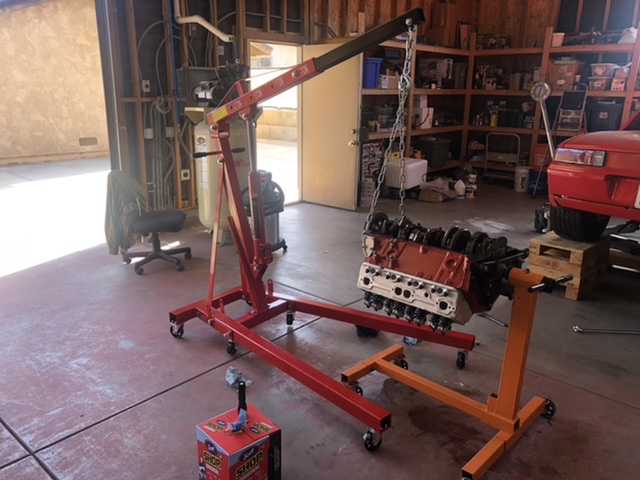

And now here is my current setup. A little more difficult to work on it and flip over but not that big of a deal.

FL 000   Alright it turns out the heads were jacked up. Too...   Jan 8 2021, 08:11 PM
FL 000   So put my heads on tonight and adjusting the valve...   Jan 8 2021, 08:18 PM
rhodyguy   WOW! That could have been a life changing even...   Jan 8 2021, 09:13 PM
djway   Holy Crap. What brand is that stand? Glad you stil...   Jan 8 2021, 09:28 PM
FL 000   Holy Crap. What brand is that stand? Glad you sti...   Jan 9 2021, 10:14 AM
808 WRX   Glad your feet are ok! Hope the motor is ok t...   Jan 9 2021, 10:48 AM
djway   Holy Crap. What brand is that stand? Glad you st...   Jan 10 2021, 01:39 AM
76-914   Aww Man. Sorry dude. I've got one of those but...   Jan 9 2021, 10:24 PM
cali914   You are lucky from the head situation and the acci...   Jan 10 2021, 01:29 AM
Andyrew   Wow that is nuts with the engine stand! I have...   Jan 10 2021, 01:33 AM
